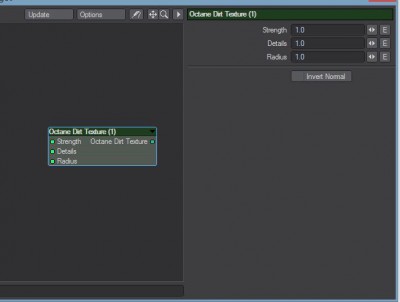

marchermitte
Posts: 283
Joined: Sat May 29, 2010 9:25 pm
Location: Geneva
Holà Juanjgon! Por fin I had some time to play with the new update... color picker is a bliss, very usefull. It definitly speeds up the workflow. Thank you!
I like the fact to be able to use some LWnodes with Octane's... in fact I'm even surprised you suceeded in making some of them compatible. It was hard to understand which ones were and were not compatible but It's clearer after you explained "You can use some nodes LW nodes with Octane, but only for pre-processing scene"
What I miss is the dirt (ambiant occlusion) node. It's key to build realistic aged textures. For now I just bake the ambiant occlusion in LW or Modo and use It as a texture but It would definitly come handy to have It as an Octane node sooner or later.
Thank you for your excellent work!
Marc Hermitte
Intel I7 4.5 Ghz, 24 gig ram, 2x Nvidia GTX 480, win 764bits
juanjgon
Posts: 8867
Location: Spain
marchermitte wrote:Holà Juanjgon! Por fin I had some time to play with the new update... color picker is a bliss, very usefull. It definitly speeds up the workflow. Thank you!
You can try the Octane Dirt node to make this kind of effects.
-Juanjo
