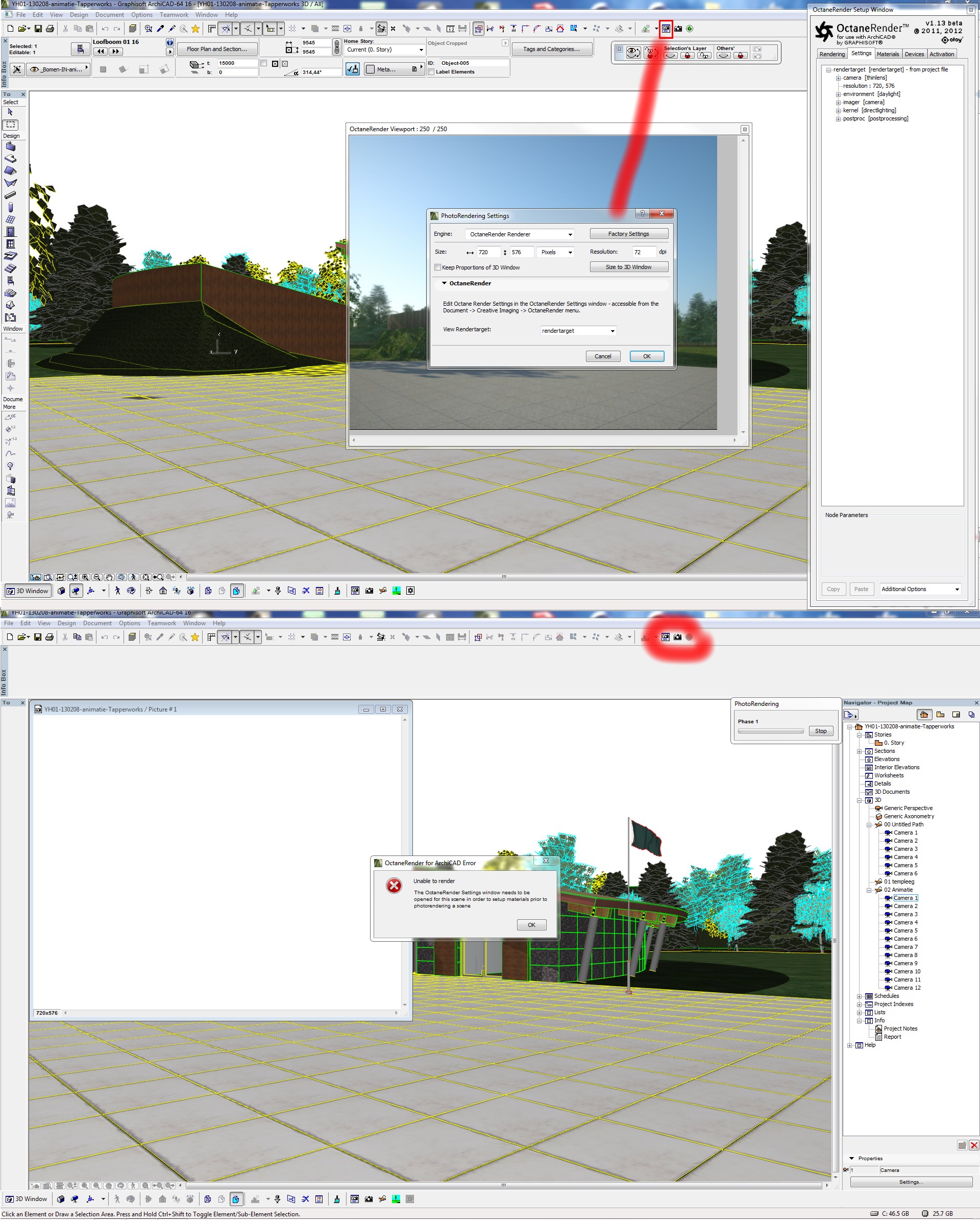

I'm having this issue when trying to render with AC photorendeing projection.
btw: working with 1.13a6

There is a link on page 4 of this thread for 1.13b2. It should fix this problem you are having.
I am away for 2 days, but will "officially" post 1.13b is the latest stable release when I get back.
Also, BfPuVAK's animation rendering problem appears to have been fixed by UNDER-clocking his card. Handy tip for people who experience the same issue.

Thnx Paul,
I overlooked the 1.13b download.
The problem is fixed.
I encountered another thing while rendering an animation (seperate jpg's):
after rendering a bunch, the rendering seems to stop whitout any error, but it shows the Samples/pixel and Phase, but just does not continu rendering.
I have to stop The Creating Fly-through pop-up and start the animating-rendering again (gladly I can start with a last-rendered+1).
I am trying to monitor the temps of GPU, but I am not sure what the problem is.
This is the exact same problem that Artur had, and it was resolved by underclocking his cards a fraction. It is something I will raise with Otoy.
