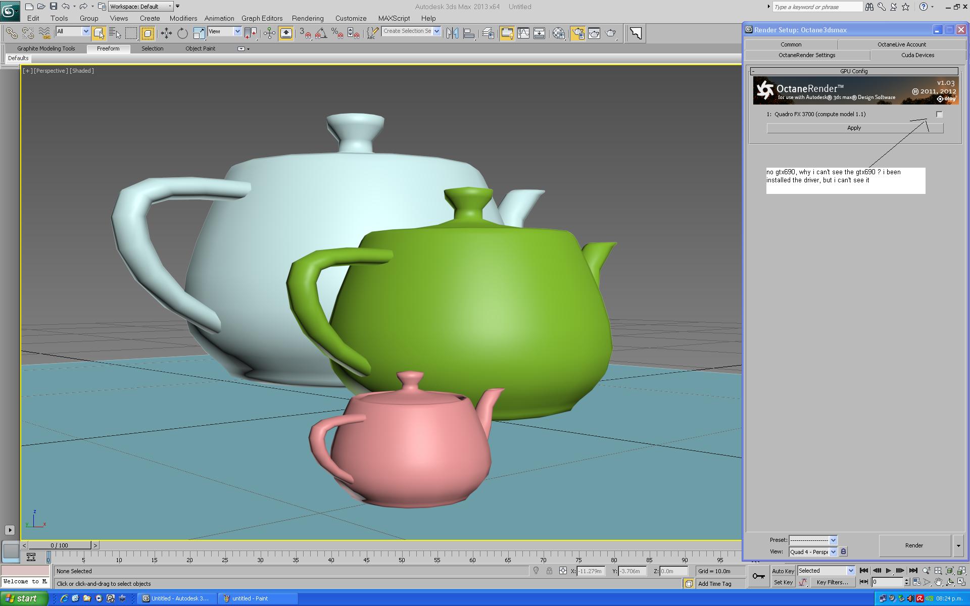

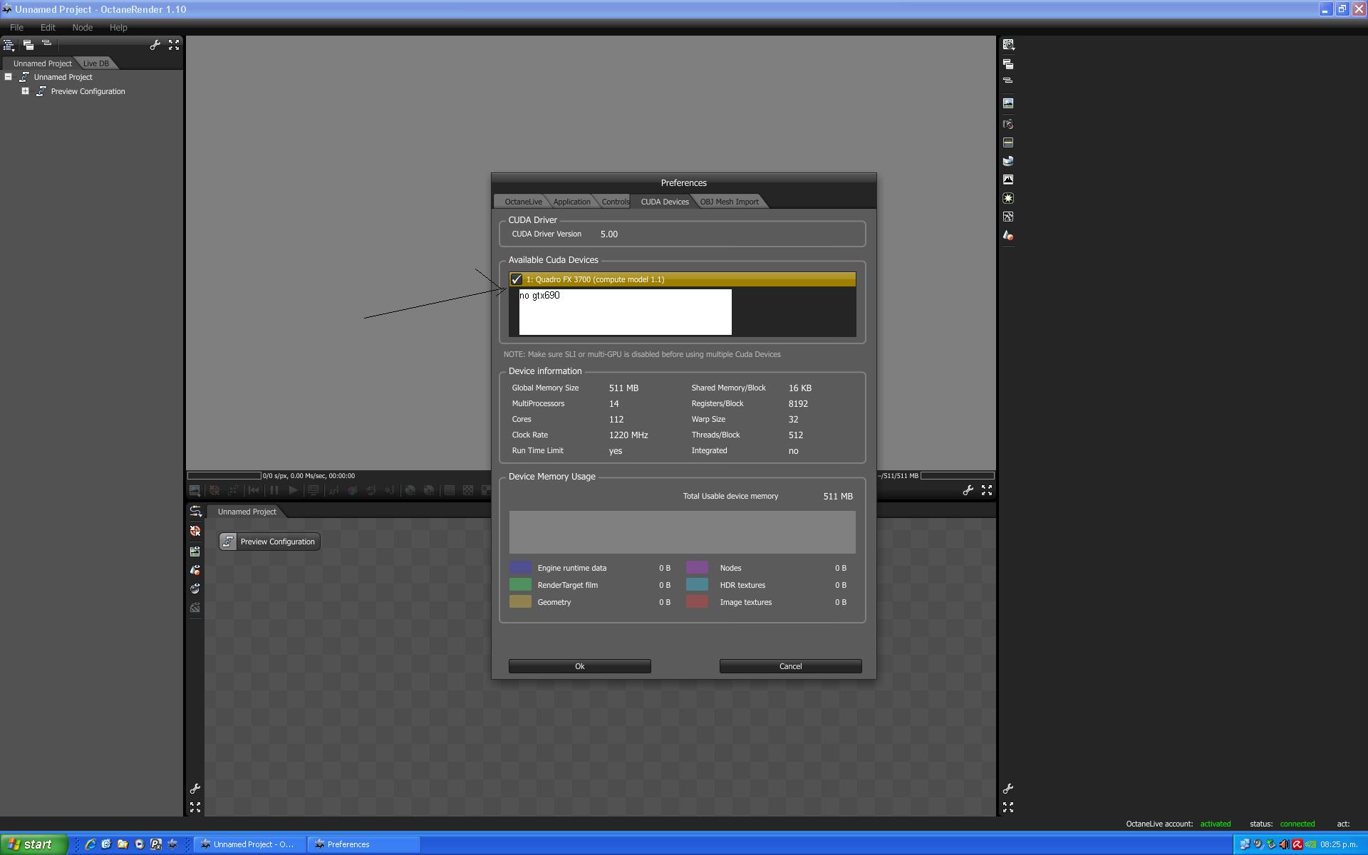

hi karba, can you help me ? i been installed the gtx690, but for some reason i can't see it in the option octanerender, maybe a problem with the driver ? i been installed the dvd driver, 306.81 x64 bits
the quadro fx3700 is only for the monitor the driver is 310.90 x64 bits
add images
Elvissuperstar007
Posts: 2620
Location: Ukraine
merid888 wrote:hi karba, can you help me ? i been installed the gtx690, but for some reason i can't see it in the option octanerender, maybe a problem with the driver ? i been installed the dvd driver, 306.81 x64 bits
add images
remove the driver for professional cards fx3700
install the drivers for 690

hi elvis, thank you for comment, i been done that, remove the driver, i been retired the fx3700 and put in the first slot the gtx690, is the same result, i think so maybe could be the bios version, perhaps update the version ? i been treaty with the x58A-UD3R rev.1 motherborad, maybe is this motherboard old, what do you think elvis ?
the quadro fx3700 is recognized without problem in this motherboard
i will update the bios version and i'll comment soon
thank you !!!
