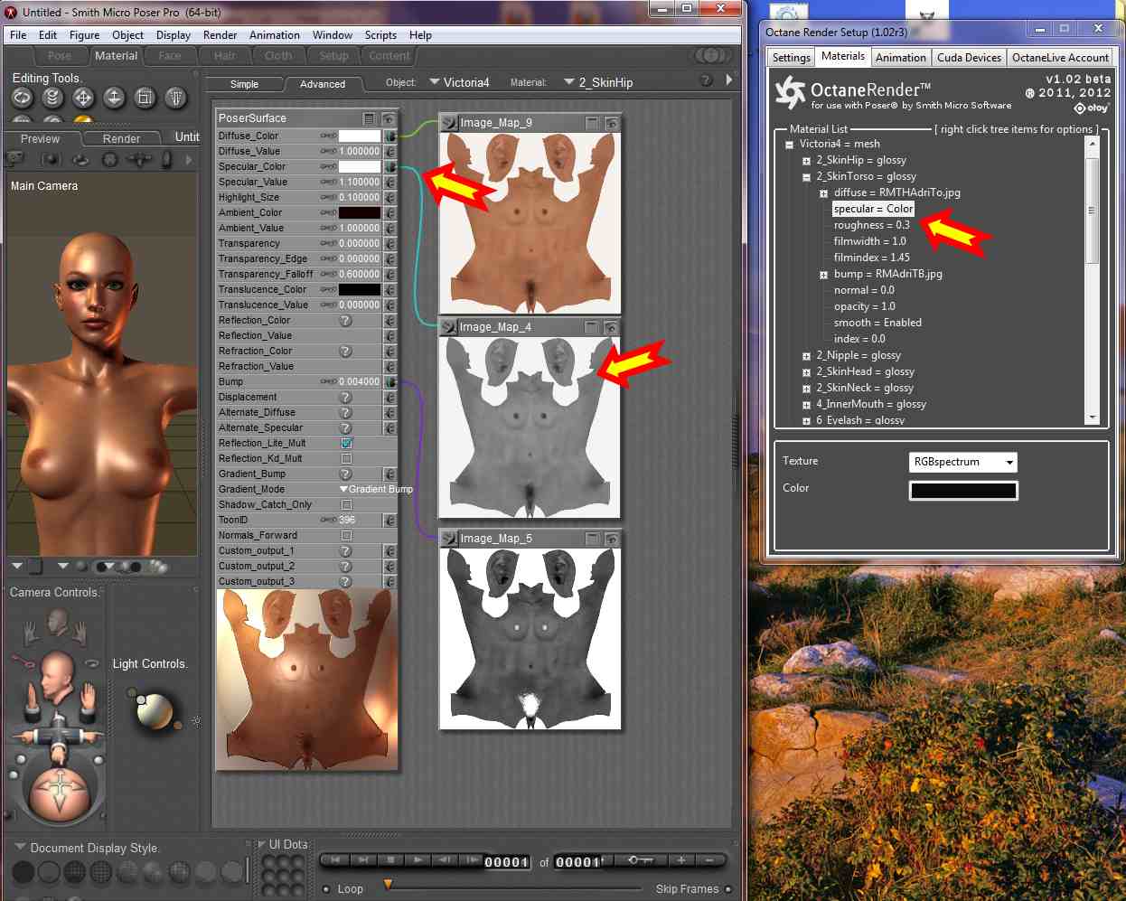

I mean the converted materials imported from the current Poser scene into the plugin. I clean up all the skin materials in Poser so that I end up with only texture maps plugged to the diffuse, bump and specular nodes. I noticed the specular nodes are usually lost in the plugin conversion, becoming "color" nodes - which is not what I wanted because specularity becomes global to the surfaces instead of being controlled by the specular maps. What do I have to do to preserve the specular maps? I tried making their values higher than the diffuse, but they still get replaced by "color" nodes.

Hmm, I wonder if by "highlight color" you actually meant "specular color"? If so, I have it connected to a specular map, but Octane pluging will not include it in the conversion, replacing it with a "color" node instead. Please see the screenshot. Am I doing something wrong? I tried reloading the material from Poser, but the specular maps are never used. I am currently using the "color" node in the plugin to control specularity, and skin ends up looking like plastic... -____-
You are absolutely right - there is a problem with the transferring of the specular map for "skin" materials. I have 1.02s packaged and ready to go - I'll include the fix in that. I was waiting for Octane 1.1 to be included, but this issue warrants a more urgent release.
Ken, on further inspection, this appears to be working correctly. The screen shot you've provided is showing 2_SkinHip, but the Octane node in the screen shot is 2_SkinTorso. Would it be possible to send a screenshot where the materials are the same? And pls rightclick the material in the Material tab of the plugin and "Re-Import this material from Poser" first.
