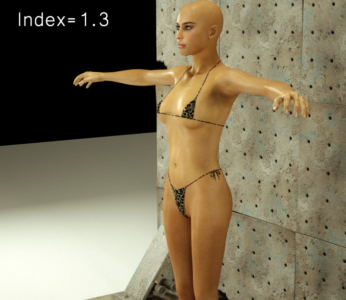

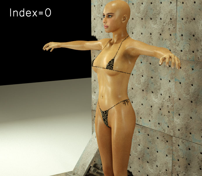

It needs to be user define IMHO. It's like inventing the wheel again but with less effects. Let me show you. Images below shows you a scene with 5 spotlights. You would expect an oiled up V4 character would reflect those lights. It does with an Index of 0 but not with an Index of 1.3. And that's even with specular set at max.
Also my scene with buildings looks flat with no shine at all with a Index of 1.3. So please let the user decide.
