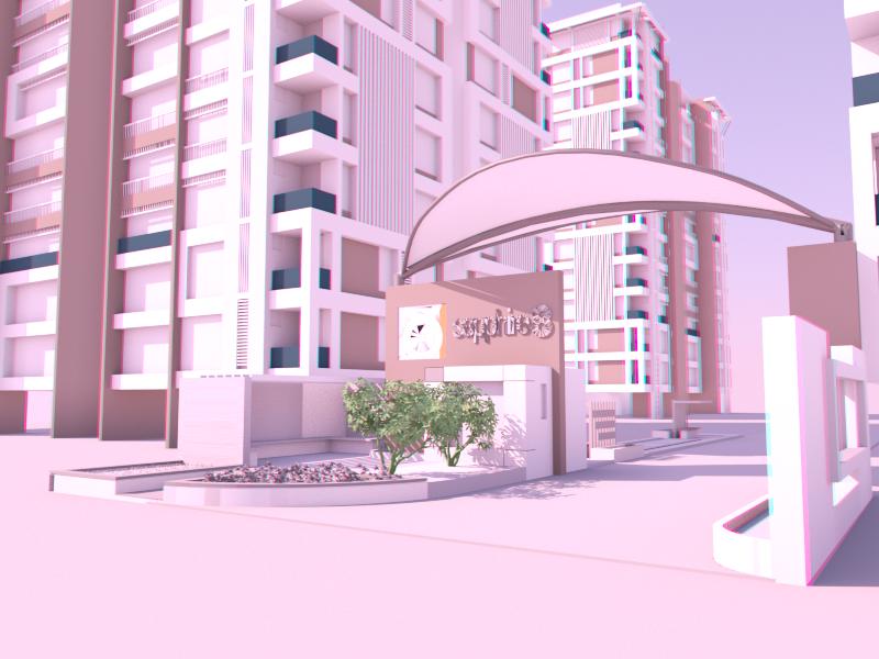

the stereo render does not render correctly somehow..I've attached both the with and without stereo images
Karba
Posts: 2300
3rdeye wrote:the stereo render does not render correctly somehow..I've attached both the with and without stereo images
Do you use the default stereo filter colors?

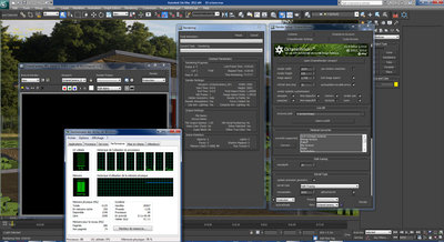

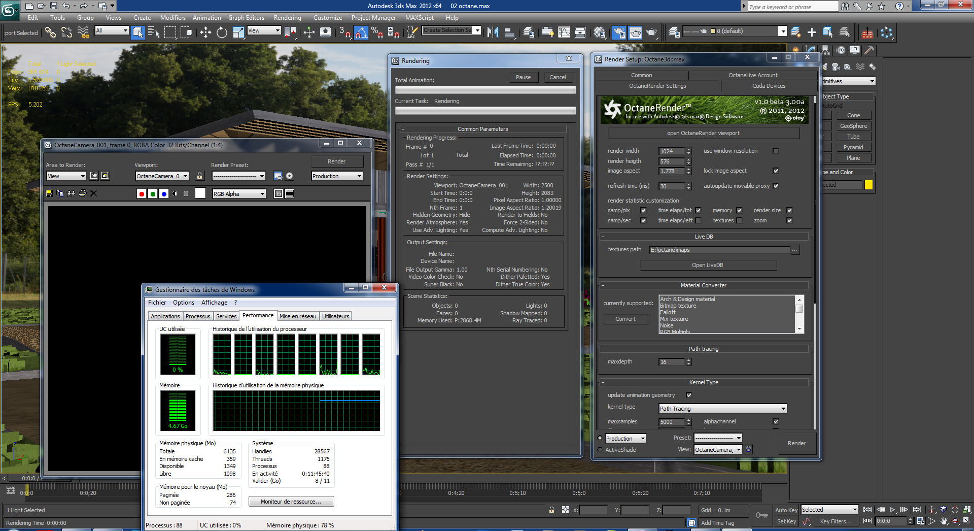

Hi !
I want to know if there is any limitation on output size depending on hardware.
I'm testing a small architectural outdoor scene, about 1.5mi of tri, rendering with a single 580gtx with 3.00a or 2.58 was the same problem.
no problem for rendering to full hd, but at higher res, i must delete some heavy objects, if i do not the rendering gets stuck after geometry processing, and do nothing (CG seems not loaded...).
With a 100 000 - 200 000 tri dropped out, the render start and is going pretty fast, and i recomposite the other elements after. I have the same problem with direct or path tracing.
After Octane viewport can ben open but no samples not rise and display just the checker grid, a ram usage of 519mb and render size is displayed "0x0"... but sometimes after a while i re-open the octane viewport and all work normaly.
i have latest whql drivers for 580, for cuda these linked on the manual (need to be updated i think, link is now dead)

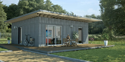

Karba
Posts: 2300
oudou wrote:Hi !
Other questions :
- is there a way to transfer the scene from octane3dsmax to octane standalone (or obj export will conserve good material settings for octane??) ?
- i'm searching for a small tut on how to use some octane material to mimic the matte/shadow material of 3dsmax ... any one can help me??
Thanks !!
How much memory does it take when you render at full hd?
How much memory does your 580 have?

oudou
Posts: 29
Joined: Mon Jul 23, 2012 10:30 am
Location: Bordeaux, France
Karba wrote:
oudou wrote:...
my 580 have 1.5gb, there is no big textures, when octane viewport works it say about 0.519/1.470gb memory... i don't know if it's for geometry+texture of just textures.
A second 580 maybe should help (the memory would be 2x1.5gb or juste 1.5gb for the two cards like in a sli mode ?)?
Even if 3dsmax plugin will be able to generate standalone scene, it will be completely unreadable for user just because it is automatiaclly created without any proper node placement in the node graph.
Hu, not very important actually, if the plugin continue to progress, but for export would be pretty good with just material nodes and objects, that's the longer to set up.
edit : it seems when i have this problem, if i open an octane viewport with a low res, so the render start normaly and after i can set up the hi res and it render fine...
