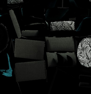

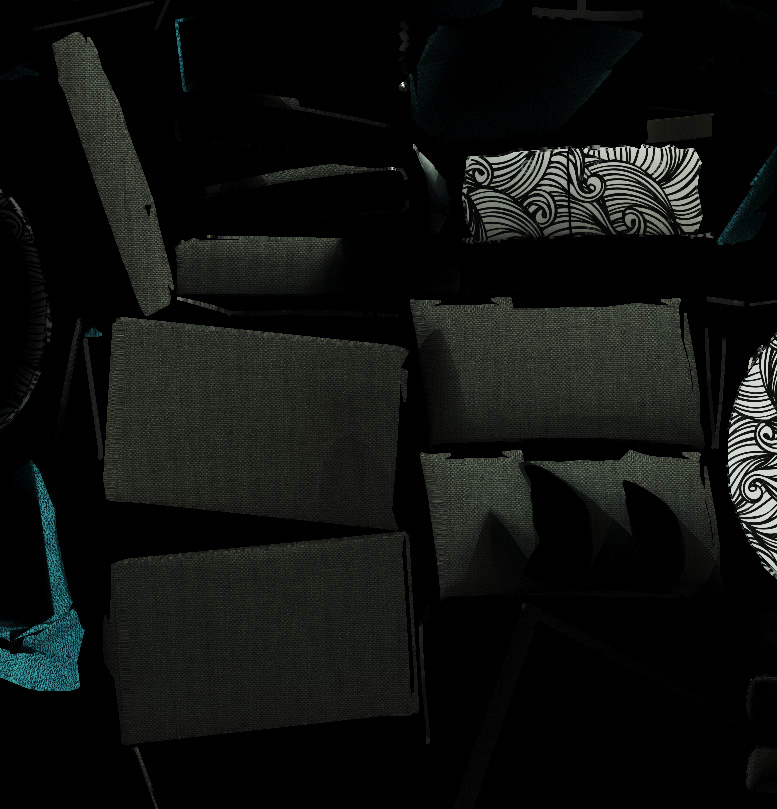

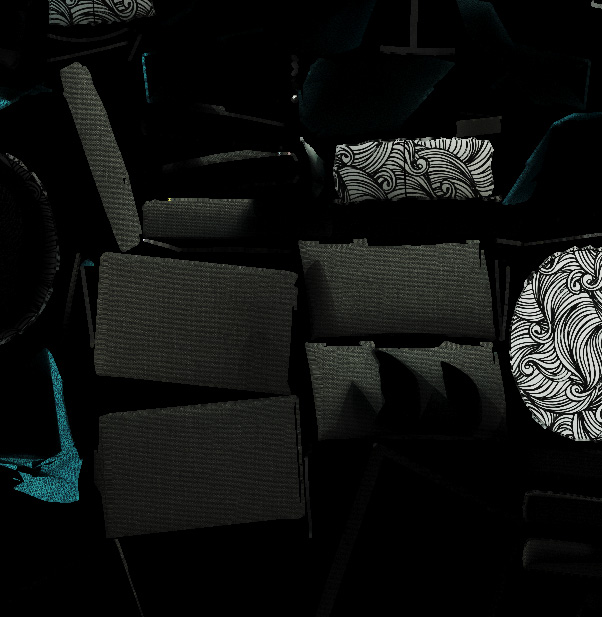

I have noticed an oddity when rendering out with the baking camera. If the resolution is below a certain size, it appears to change the scale of some textures, like with cloth, carpet, any small/repeatable texture. It looks like it's not anti aliasing correctly.
This is how it should look:
If I lower the resolution it appears the texture has been scaled up, ie. more coarse:
I can upload more examples if this isn't clear.
Cheers,
Dino.
