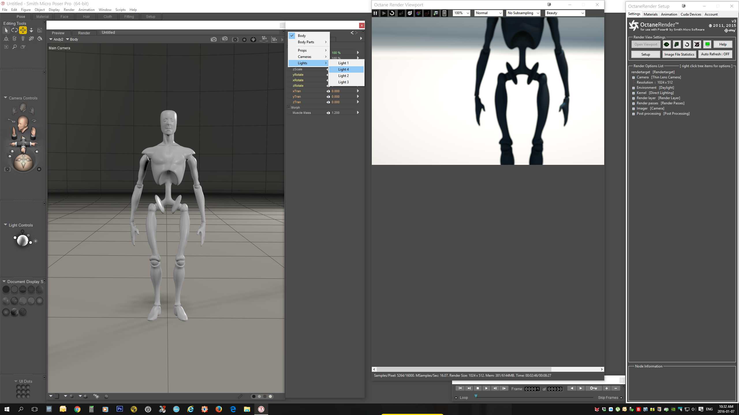

RGUS
Posts: 321
Joined: Sun Mar 17, 2013 1:32 am
Location: New Zealand
No Daylight to rotate anymore...
Attached is a a screen capture showing Octane set to daylight environment but no daylight option in Poser to rotate and change...
Have I buggered this thing up somehow?
