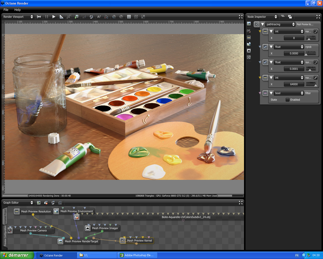

This scene has been rendered with 64000 samples per pixel, in around 10 hours. Rendering with Pathtracing was necessary because of half-transparent materials. As the transparency effects with Directlighting didn't allow to setup the materials, the whole setup has been done with Pathtracing enabled.
It was really difficult to setup because the glass area has been very noisy for a long time and it was not easy at all to see the effects of the settings. Getting details in the jam area required much light, and so I fear that the other parts of the scene are a bit over lit. Despite the very long rendering, many remaining hot pixels have been removed.

As there are three transparent materials and four transparent surfaces (glass, water and diluted paint) and because the water and the diluted paint effect are behind transparent surfaces, it was difficult to select them. So I have added invisible objects under the table using the same materials. It allows to select the materials without using the scroll cursor of the GUI, which is not responsive enough on my machine.

As I have to stay around 50% of my memory capacity (otherwize I can't reload my ocs without loosing all settings), In this shot I have used a low def image for the table (the same image as the brush wood) to save memory. Also, I have had to increase the size of the table in order to avoid showing the empty background this has increased the size of the texture and is cause of pixelation. As said previously, I can't render in higher resolution without crashing, and this scene already required 10 hours of rendering in the current resolution !
