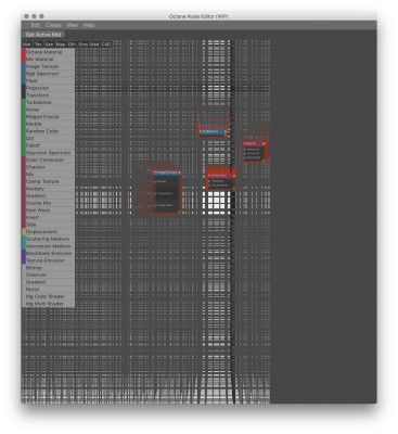

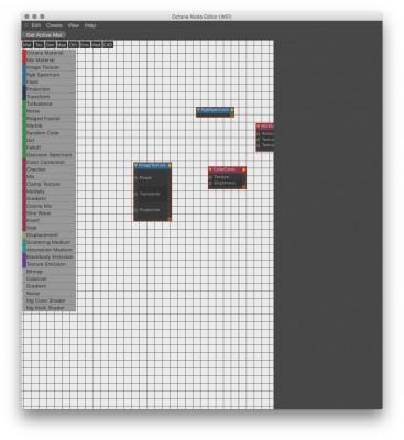

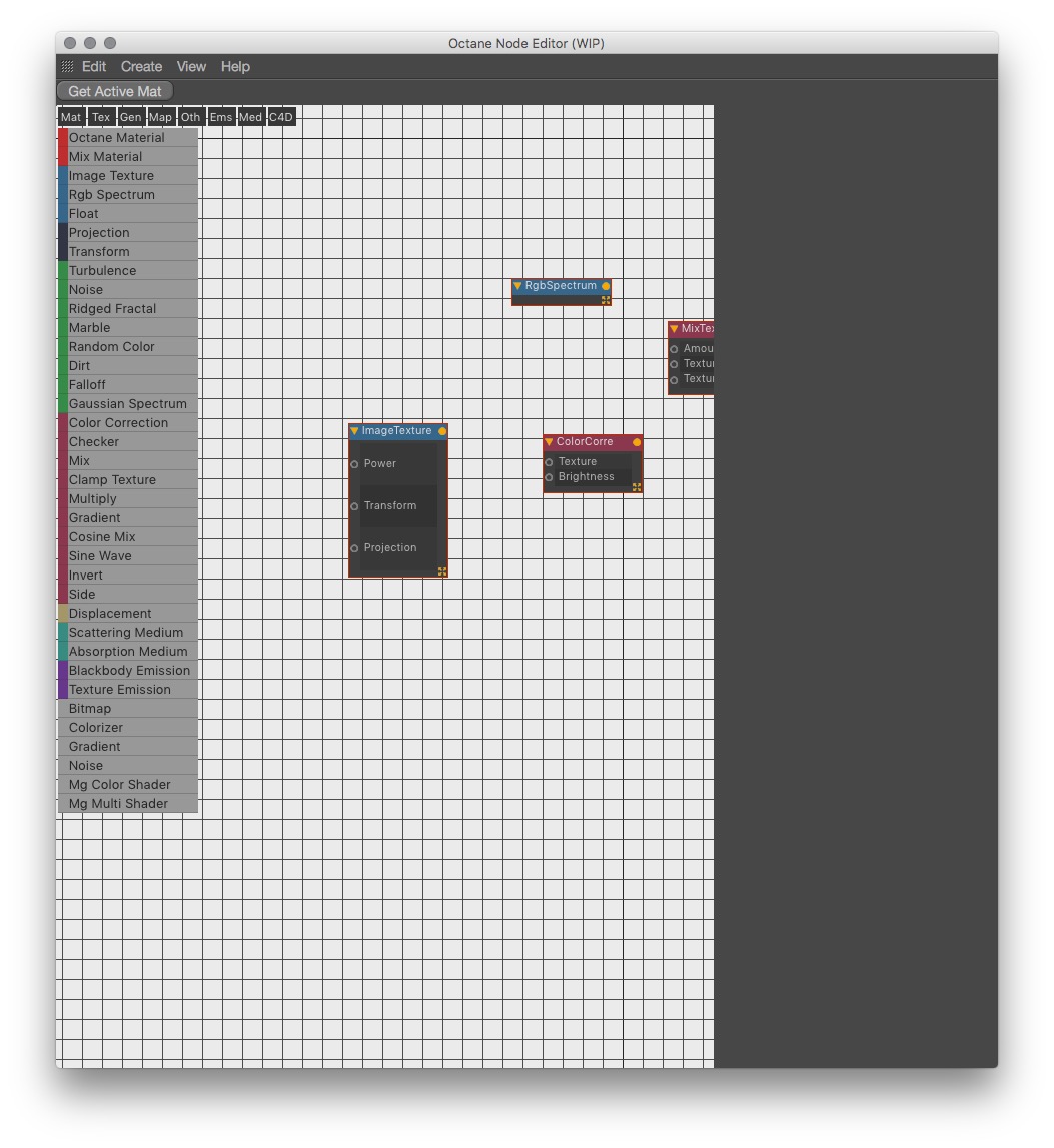

Since updating to El Capitan and test 5.2 the Node Editor doesn't work (maybe its coincidental and not related to OSX?). It also doesn't work when reverting to a previous version of Octane. Here are the problems:
- Doesn't update to show currently selected material (and won't refresh)
- Sometimes does not show anything at all
- Issues with nodes becoming 'orphaned' or unresponsive
- Right-click contextual menu no longer works at all (so cannot delete nodes).
- Dragging a new node from the left menu fails to add a node. Repeating action results in two of the same node.
Problems are generally worse when the window is docked. Undocking causes corruption of the display of the Node Editor:
(R17, OSX 10.11.2, Octane test 5.2)
