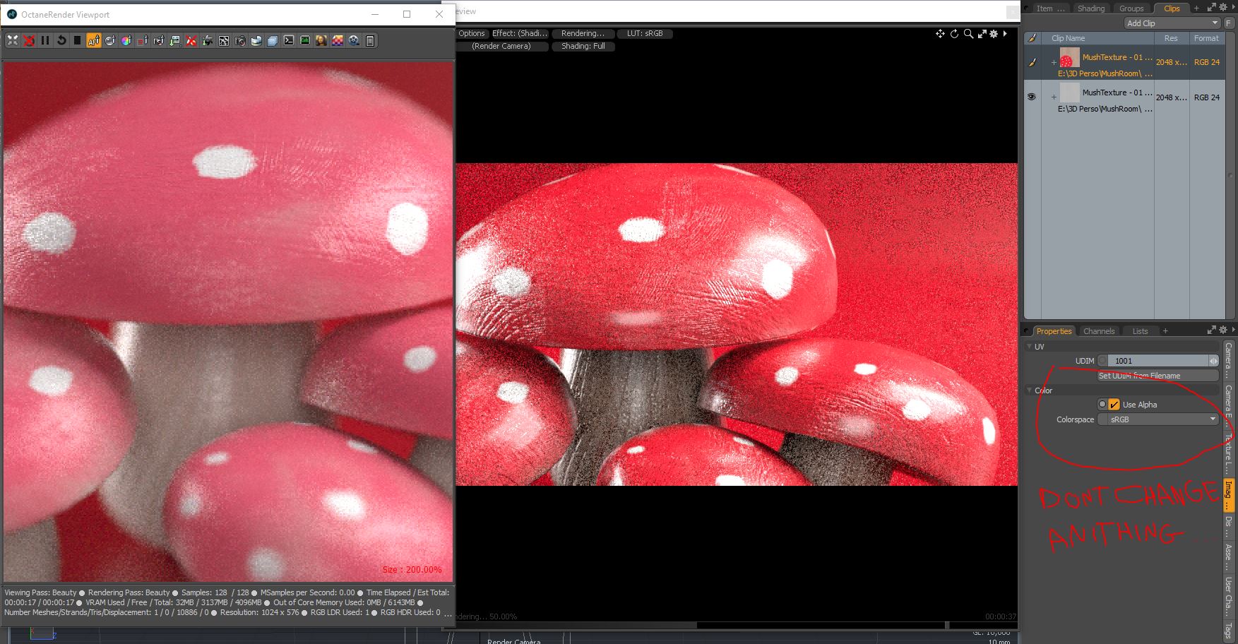

Didn't update my octane plugin in a while, but with the last version i'm facing an issue, octane doesn't use the modo colorspace setting for my texture, they are all washed out at render while the modo renderer display the good corrected texture.
Did a miss a recent change in octane ? It was working flawlessly before and never had to change settings for my map
There are no obvious changes in this area. What version did you have installed prior to 2.24.2.89?
For colorspace settings - pls see https://docs.otoy.com/Modo/?page_id=959.
Paul
Don't know, last time i updated was in august, so maybe version .87 and 901 sp3
I tried changing the parameter like the link you gave me but that doesn't fix the issue, my map are still washed out (like if loaded them with a 2.2 gamma) on octane but show up fine on modo renderer...
The only way to fix it was to directly change the gamma setting on the map in the shader tree and put 0.4545 in there (inverse of 2.2 gamma) never had to do this before on any other octane project, even on this one who was working before updating.

Flyx wrote:
Paul

v1adut wrote:Hi flix In order to get the same render parameters ad modo viewport set these into octane render and it will match your modo gamma.
Go to Octane Camera/Imager Tab
Exposure 1
Gamma 2.2
Response Time Linear on/off
Cheers,
Vlad
See if this works
My scene already have those parameter, it was working before updating the octane plugin so i guess i comes from the plugin :/
Would it be possible to send me the scene pls, so I can investigate the problem.
