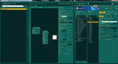

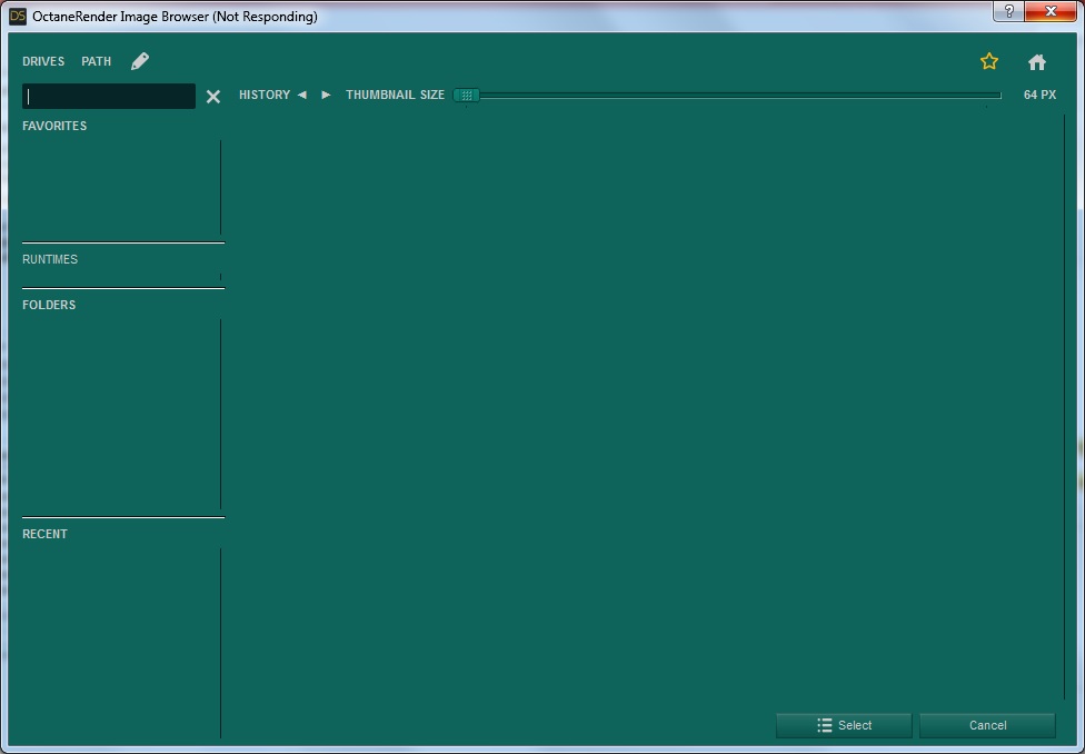

I still can't click '...' in the NGE;
I get an error "DAZStudio.exe caused GUARD_PAGE in module "C:\Program Files\DAZ 3D\DAZStudio4\MSVCR100.dll" at 0033:0000000064A4C24D, memmove()+749 byte(s)", then Daz crashes.
I briefly see a blank menu.

Paul, none of those things worked. It still crashes.
Intel i7-4790K, Asus Z97-A, Corsair 32GB DDR3 1866MHz CL9, 2XAsus STRIX GTX980 DirectCU II OC 4GB, 4XSamsung 840 EVO Raid 10, Win 7 x64 Pro.
face_off
Posts: 15830
Location: Adelaide, Australia
I have added some additional error check in the next release, which will hopefully either resolve, or help identify the problem.
