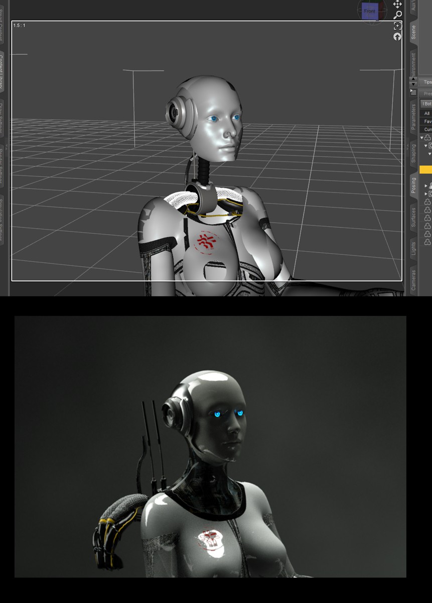

Found some strange issues in Octane 3.07.
I've bought "I Bot Nurse" for Genesis 3 from Pamavo on Renderosity. When I try to render her in her zero-pose all seems to be ok but after applying a pose (doesn't matter which one) the geomety is broken in the octane viewport/render.
When I render her in IRay there are no problems at all but there seem to be some problems for the oc-plugin to read the geometry.
This happened before (in earlier versions) for some smart/parented props (e.g. some weapons for the left or right hand) - In those cases I found a workaround - I hade to load the prop, export it to 3DSMax, center the origin and re-imort it to DAZ studio. But this won't be easy for a character like the I Bot. Is there a fix for this problem?

MyRho wrote:Found some strange issues in Octane 3.07
This happens quite often for me, mainly when I use parented props. After trial and error I found that sending the render to "Final" and then ending Final will usually resolve the problem with the offset props. Not sure about the neck though.

MyRho... That happens to me quite often. In the preview window, I just do a "Rebuild Scene", and the geometry/positioning will correct itself.

Hydra wrote:MyRho... That happens to me quite often. In the preview window, I just do a "Rebuild Scene", and the geometry/positioning will correct itself.
Yes same issues for me, and rebuild scene helps to correct the position.
If you can reproduce this issue on a simple prop which doesn't need to be purchased from the DAZ store, I can take a closer look.
