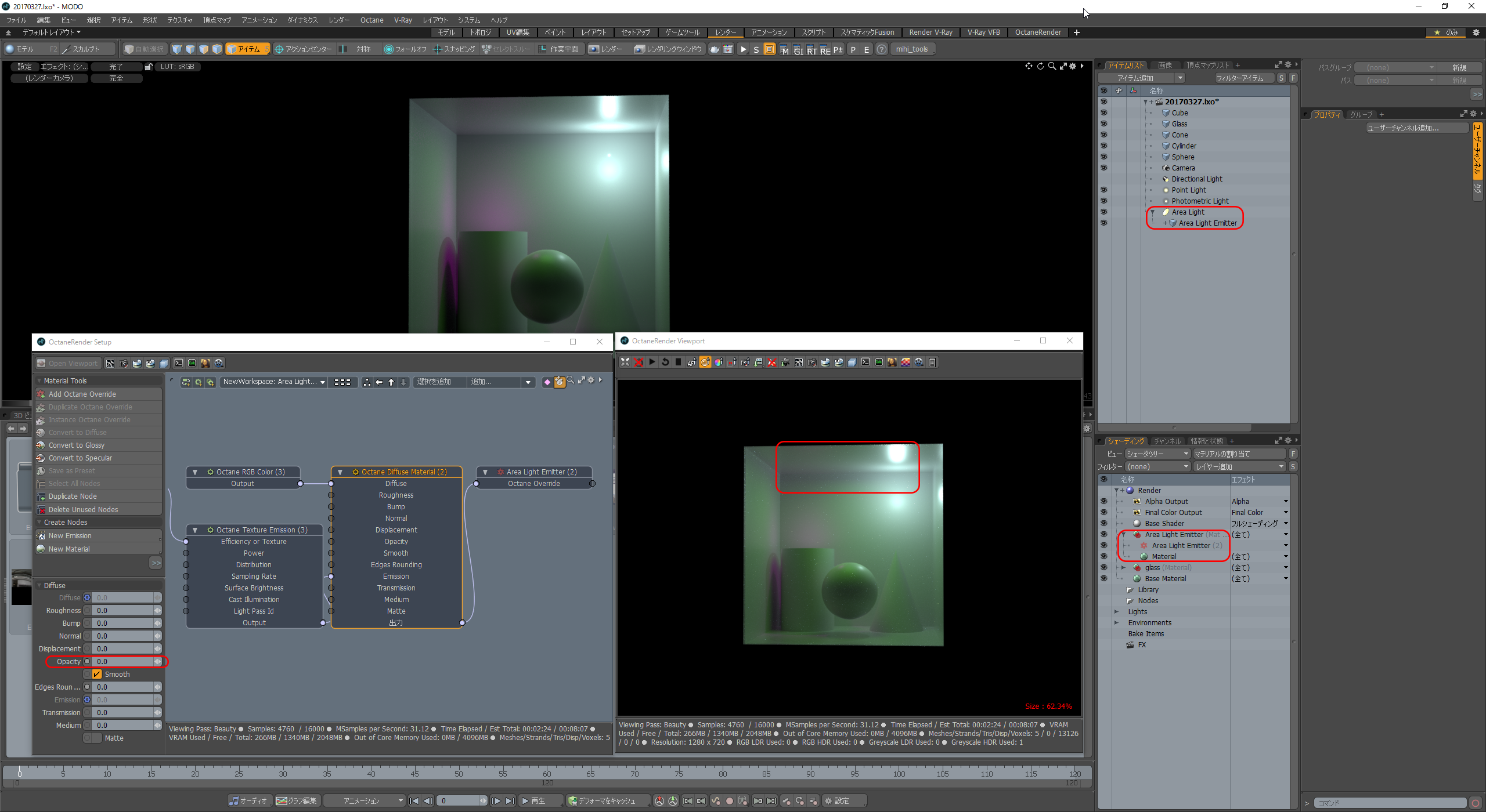

funk wrote:cubic: I looked into this. Unfortunately, Octane doesnt have a way to hide emitters ONLY through refractions (transparency) like modo does.
To funk
thank you for investigating.
My explanation was insufficient.
You can solve the problem displayed by adding "Create Octane Emitter" to the area light.
funk
Posts: 1206
Joined: Mon Feb 07, 2011 1:24 pm
Location: Australia
cubic wrote:You can solve the problem displayed by adding "Create Octane Emitter" to the area light.
Right. You can make your own emitters manually, if you know your light is behind some glass (this still won't match modo reflections/refractions though).
We just have no way to do this automatically

funk wrote: Right. You can make your own emitters manually, if you know your light is behind some glass (this still won't match modo reflections/refractions though).
Thank you for your answer.
In this case you should do it manually.
