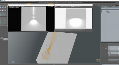

The Photometric light still doesn't work correctly for me.
But again: Thats a really nice Release!
OctaneRender 3 for Modo [OBSOLETE]
Moderator: face_off
Hesekiel2517, the current photometric conversion uses a flat plane which can only project light in 1 direction. Your light is projecting in all directions and requires a spherical emitter.
I came up with a conversion for these types of lights too, and we were originally going to do it this way. Unfortunately, using a spherical emitter was generating more noise and took longer to clean up, so we decided to go for a flat plane.
I talked about this with Paul, and we may be able to add options to the light form in the future, which will allow users to toggle on spherical emitters.
Can you upload the ies file?

Ahh, i see. That would be very nice if there was an option to use a spherical emitter.
Thank you for the fast reply!

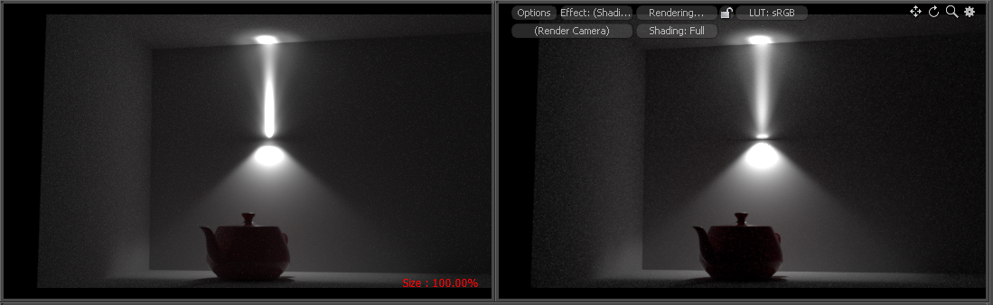

I tested your file with my spherical emitter conversion. It's a lot closer, but seems to generate different light depending how I place it on a wall.
There are a few differences with how octane and modo handle photometric lights, so we will never be able to get a perfect match.

Thank you for the effort! I think your example is pretty close. It would be great if i could get this result with modo and octane.

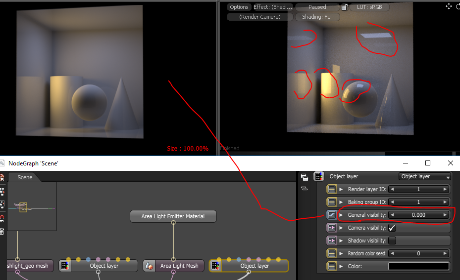

cubic: I looked into this. Unfortunately, Octane doesnt have a way to hide emitters ONLY through refractions (transparency) like modo does.
I tried using material opacity, and object layer general visibility, but none of them produced the result we need. Hiding emitters through refractions (transparency), will also hide them from reflections
The other problem is that they would also be hidden when viewed without glass...
If anyone has any better ideas, let me know
