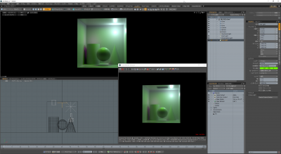

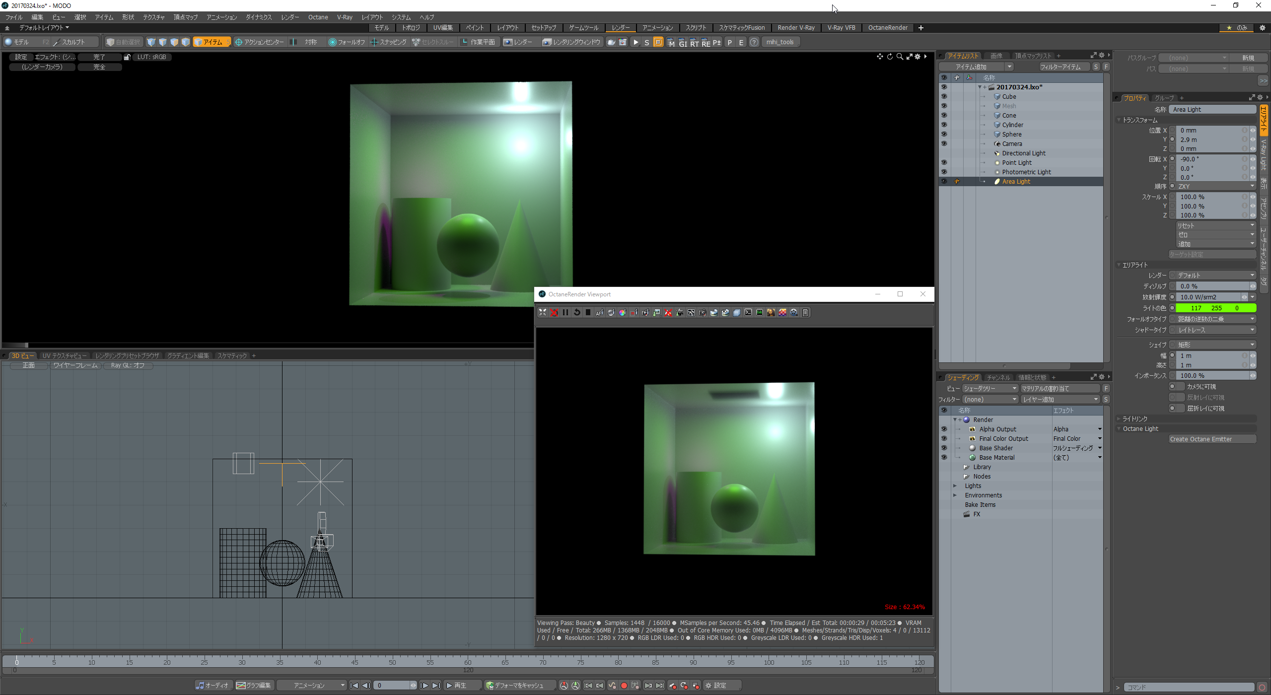

Shadows fall when the area light is near the ceiling.
This is fixed in the next release (thanks to Funk who found a sneaky solution). The next release also supports rendering area/point/photometry lights created after the Viewport was opened (ie. no scene refresh required).
