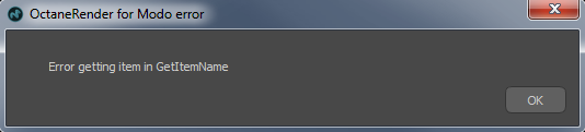

HELP!
Octane for 3ds Max v2.21.1 | i7-5930K | 32GB | 1 x GTX Titan Z + 2 x GTX 980 Ti
face_off
Posts: 15809
Location: Adelaide, Australia
HELP!
That error means the Modo API failed when the plugin tried to access an item name. I have never seen this happen before. I suspect it is due to a corrupt lxo file. Would it be possible to send me the scene pls?
Paul
