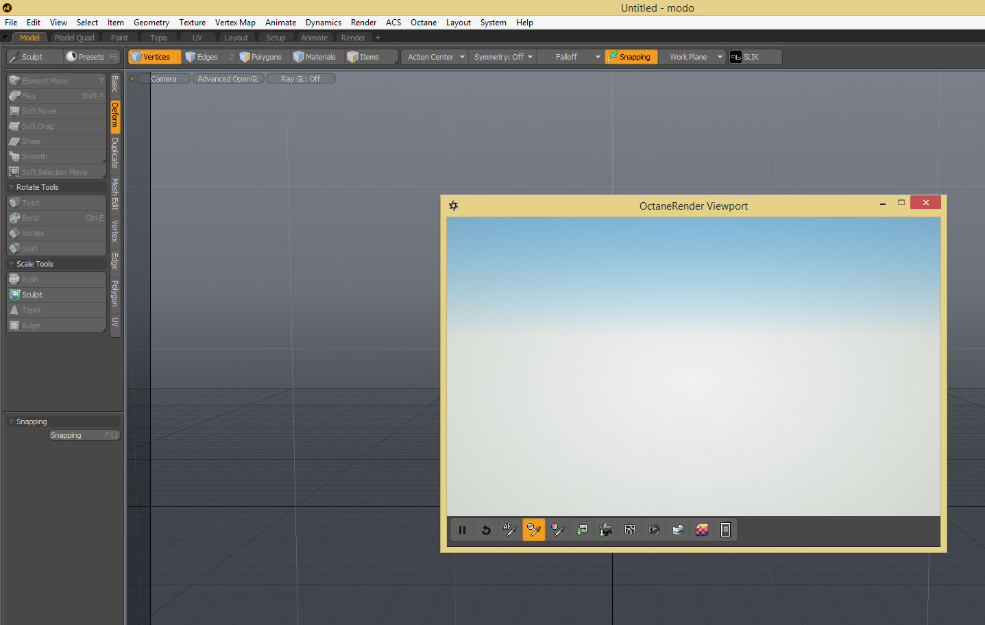

Hi Paul,
I want to thank you with the courage and hard work to develope a modo plug in.
Here is a suggestion for the GUI, for me it is annoing to have that control window flotating and moving and dissapearing.
I suggest to put to control bar on the bottom of the preview render window. Why button, well because when we click to see the drop down menu, they will be down in most cases and not overlaying over the preview render window.
Hey you all modo users, how you dare to betrade modo render engine.... :P Never mind :) octane has a more natural fill, yup :)
