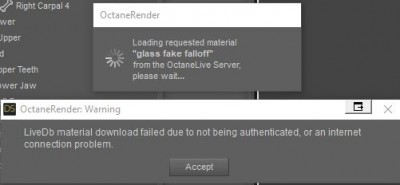

Why does this happen on some LiveDB materials but not others... never use to.
Have the materials been deleted and the plugin doesn't know what error to call?
I have seen these errors too on rare occasions, but not been able to isolate the exact issue. If you can provide the data requested at viewtopic.php?f=44&t=58932 that will help progress the issue.
I have heard back from Otoy, who say that that material and others are currently broken on the LiveDB server, and will be fixed shortly.
