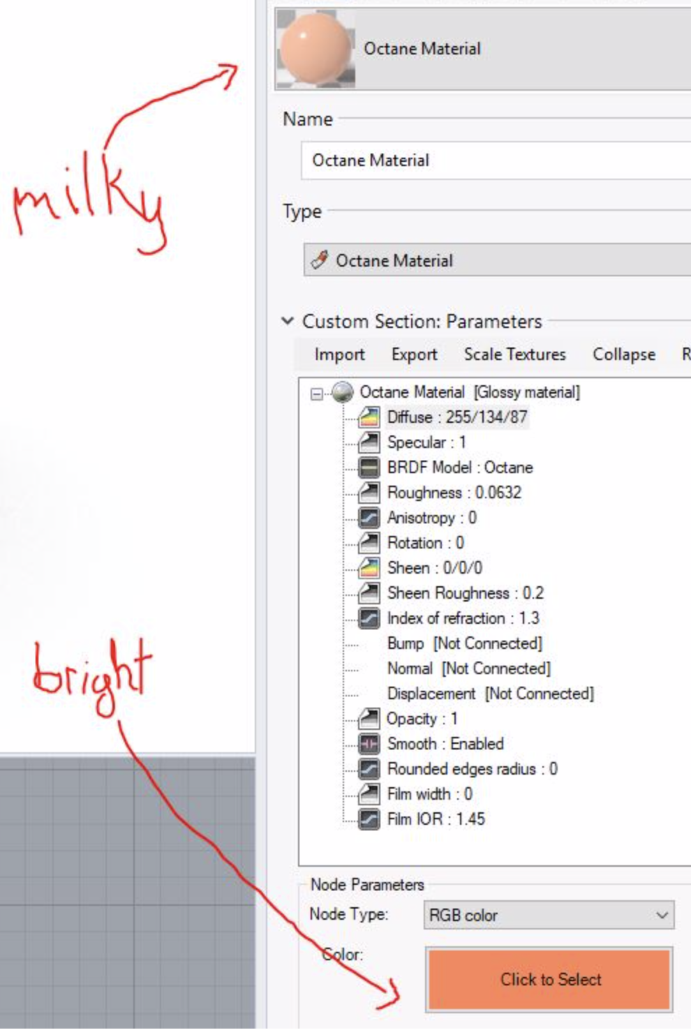

The only thing is that the material preview ball looks a bit too milky. It seems the color management is different for that. Can the material ball color correspond 1:1 to the diffuse color box?
The other question I have is the appearance of the color in the viewport. Rhino makes it quite shiny and soft color while octane shows it really strong as setted up.
I think this is because the Rhino viewport is excessively reflecting the environment. The plugin converts an Octane specular value of 1 to a Rhino material reflectivity of 0.5, and you can see that even at 0.5, the Rhino viewport if reflecting a lot of the environment.

Could it be related to Color Management in Rhino6 that the Shader preview looks brighter then the diffuse color?
face_off
Posts: 15821
Location: Adelaide, Australia
The milkiness is due to you having Specular = 1.
