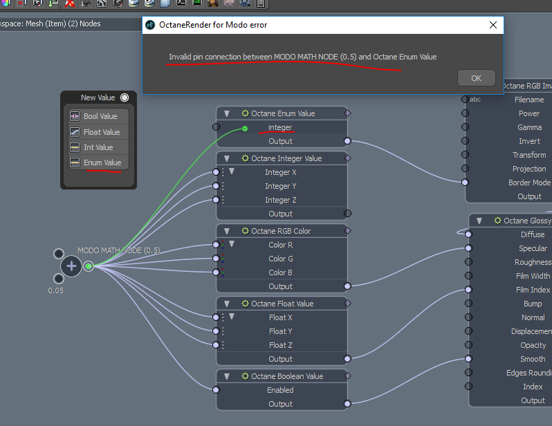

BUG: Enum nodes will not accept any modo input. Float, int, bool, rgb ect, all accept values correctly
This is fixed in the next release.
