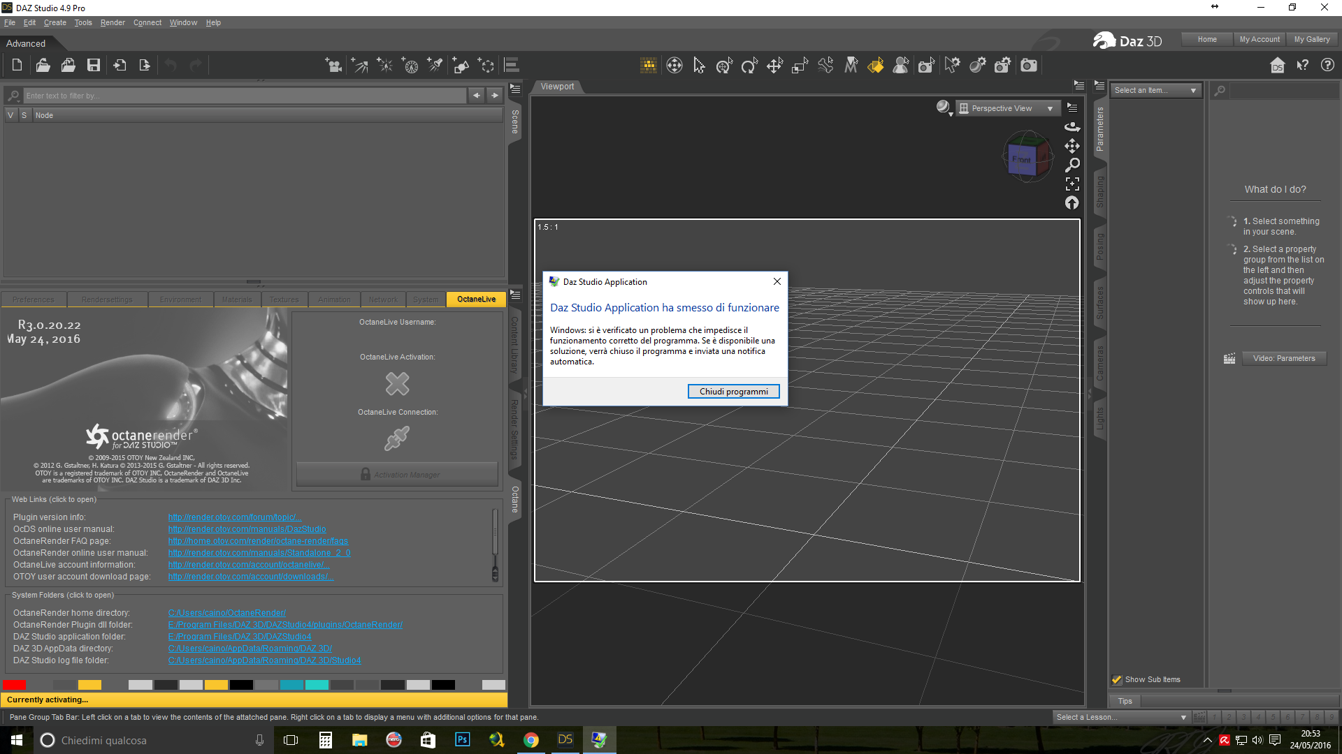

I have upgraded to Octane V3 yesterday, Then I have installed the standalone and the latest plugin for DAZ Studio (v3.0.20.22), but the software crash when appear the vieport.
I use Daz Studio Pro 4.9 (last version);
My card is a Gtx 980 (last drivers installed).

If you have an error, can you pls follow the instructions in the first two lines at the top of this thread...
Pls read http://poserphysics.blogspot.com.au/201 ... pport.html prior to posting support issues.
NOTE: For people who experience a DAZStudio crash after upgrading to Octane 3 - deleting C:\Users\[username]\OctaneRender\Data\OctaneRender_settings.oczdb may resolve the issue.

This is my PC configuration:
- Operating System: Windows 10 Home 64bit
- Amount of RAM: 32GB
- Graphics Card(s): GTX 980 4GB
- Nvidia driver version: 368.22
- DAZ Studio version: Pro 4.9.0.63
- OctaneRender for DAZ Studio version: DazStudio_3_0_20_22_Win64
I followed the istructions to delete this file = C:\Users\[username]\OctaneRender\Data\OctaneRender_settings.oczdb and the error that I posted in the previous post (Image) continue on the DAZ Studio Pro 4.9.0.63, Instead the DAZ Studio Pro Public Build 4.9.2.67 now works perfectly
