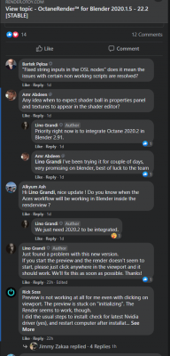

So that's not the free tier correct??
You should reach out to lino grandi
I think on one of facebook posts he mentioned he wanted to hear from those with newer rtx cards.
