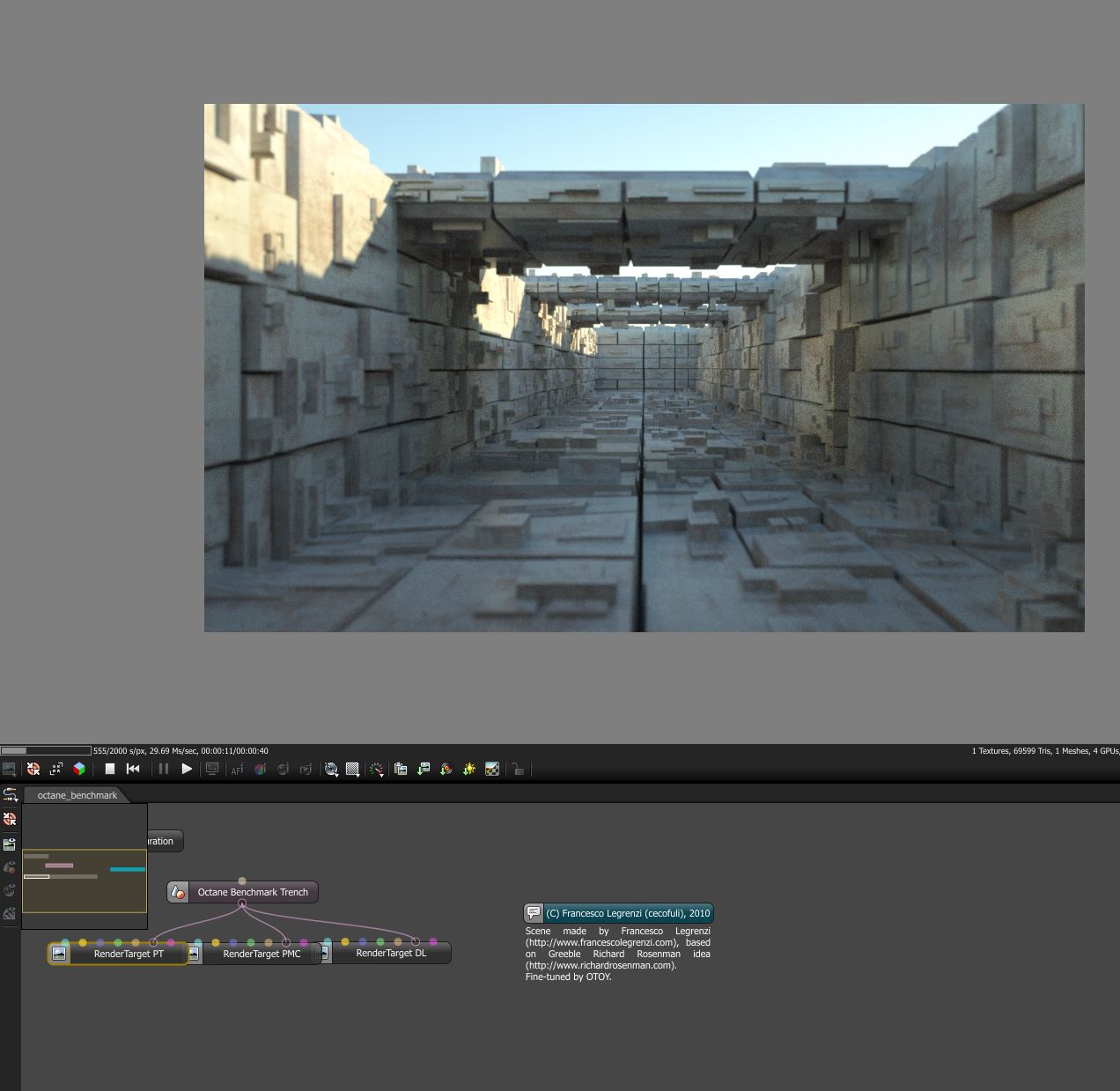

Hi all-
I upgraded my home computer with 4 GTX 780's to help render when I'm not at work. I run Titans at work and my home computer was feeling a little slow. Very impressed so far. Right out of the box these seem to be running at 90% the speed of the Titans. A little over clocking and they should easily be just as fast. Screen shot is with PT (29.69) DL gave me a solid 90.
Nice cards for less. Of course less RAM too, but I can deal with that.
Alec

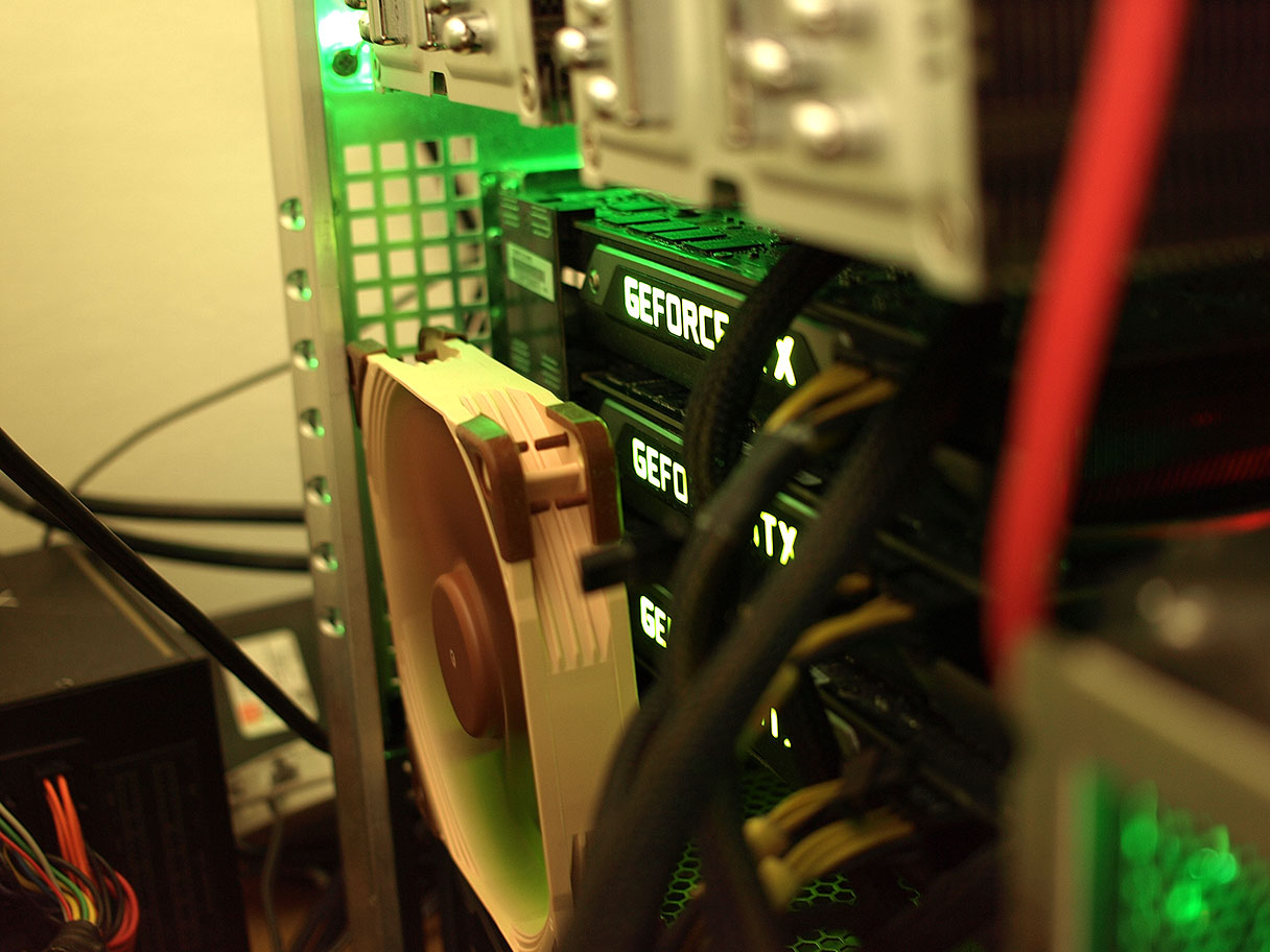

WOW! Six TITANS! Damn. Did you post any scores here? Love to see that. Any photos?BorisGoreta wrote:Juct checking in to report that there are no OpenGL issues with 6 TITANS on Windows 8, no need to have any of them in SLI.

Three are in Asus Z9PE-D8 WS (fourth PCI slot is used to connect motherboard to Netstor expansion box) and three are in the expansion box. There is room for one more in there but local shops were out of stock at the time.
