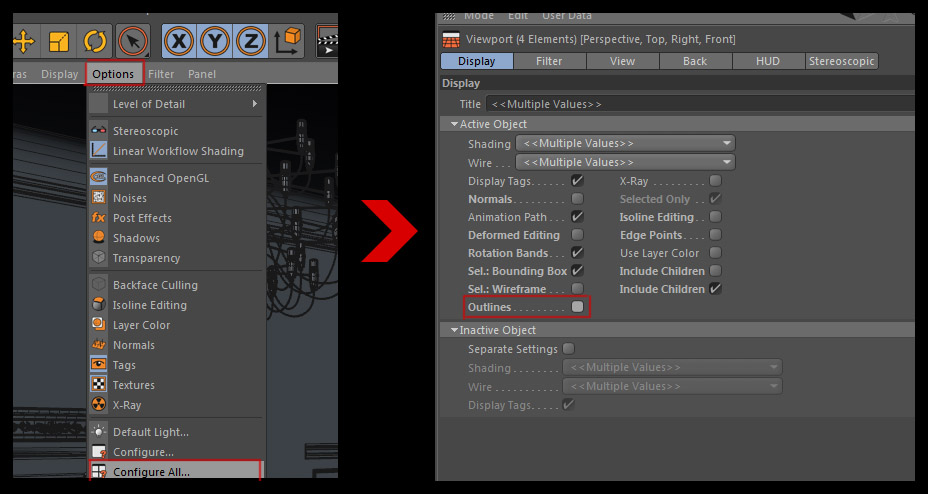

aoktar wrote:
sadece wrote:thanks for the update. Octane is getting better and better day by day with your effort.
there is an issue sometimes bothering: render restarts while moving the mouse on the C4d viewport. :roll:
keep "geo. updates" off, as a workaround. Many objects can trigger messages, hard to detect %100.
I guess figure it out where it comes from. When deactivate the Outline then the problem has gone. Hope it helps.
Edit: still some triggers but rarely.

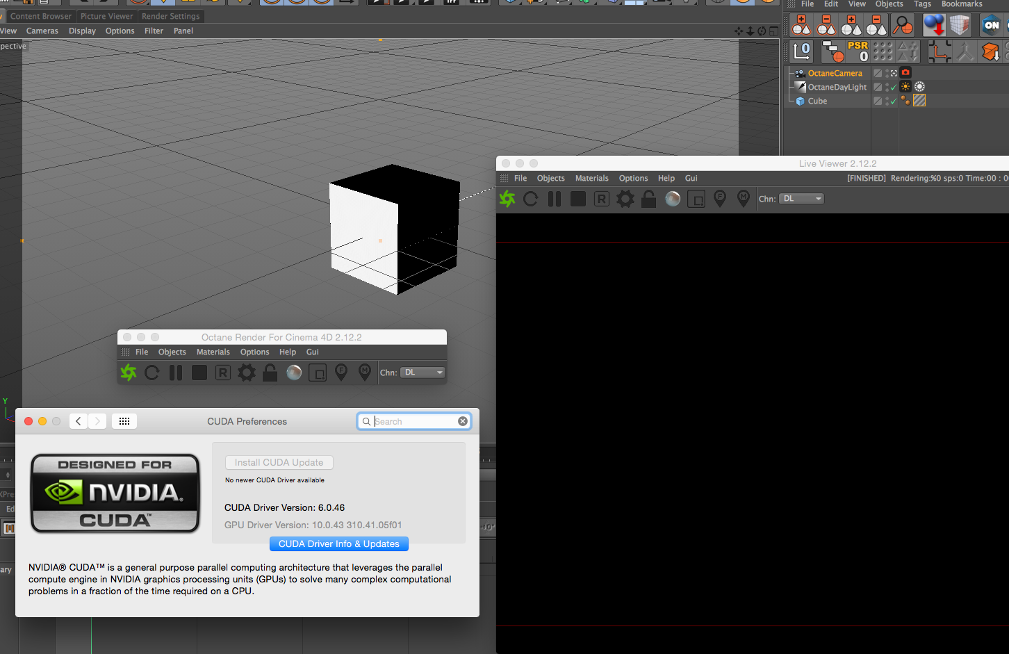

I've just installed the v2.12.2 (both standalone and C4D plugin) on my Mac.
I am running the latest CUDA drivers.
Live Viewer render anymore. Only black.
I also tried downgrading to v2.06.1 - same problem.
Am I missing something obvious here?
Could this be an license activation issue?
Thanks in advance!
Screenshot
Screenshot

pBarrelas wrote:Hey Robert, nice to see you here.
Why don't you install the latest versions? 2.14
Because it's only a test version... but you're right. I will at least try it out now.
There we go! I guess it was the CUDA driver after all!
Even though it said "No newer CUDA driver available", I could manually download a newer one. Now it works!
