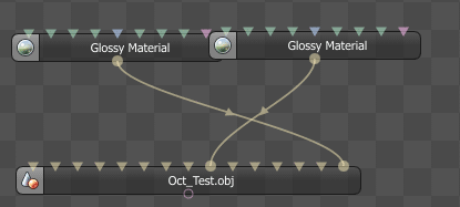

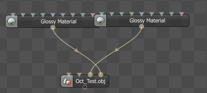

Have found a issue...
If you use nodes, the nodes are switched there positions.
eg.
You have 2 materials, in the first slot you connect a diffuse and leave the second as it is.
After reload the scene in Octane, the first slot is emty and the second have the diffuse node...
Have make a video to document it.
Have compare the exported objects and the mtl´s, and they are the same.
Looks like a Octane issue.
Maybe your error is, that Octane will switch the position of one node and can´t, so that you have the runtime error.
Will post the video unter the support thread...
A workaroud it, don´t use nodes ;)
