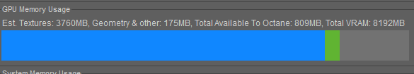

Is octane displaying info incorrectly or am I just not understanding something. I have 2 1080s. I know the memory doesn't combine why it it showing I've used up almost all of the vram. One 1080 has 8gb of vram but according to this, I've only used 3760 vra, but only have 809 left out of 8192?
face_off
Posts: 15830
Location: Adelaide, Australia
I suggest comparing with Octane Standalone to see what it reports from your cards.

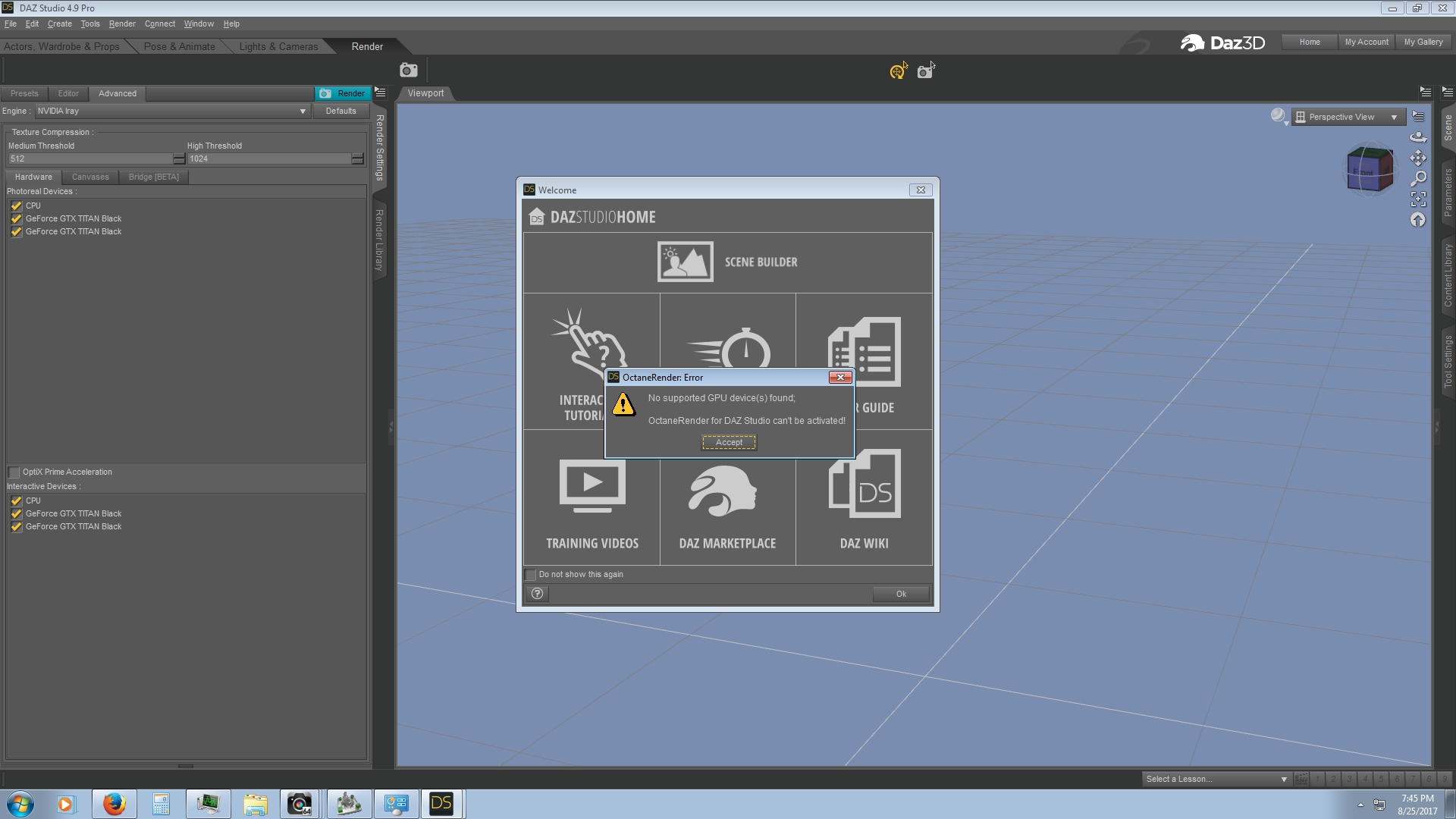

What is going on here? I have no problem running Octane for Carrara using my Titan Blacks but it seems that for some reason Octane for Daz Studio doesn't recognize my Titan Blacks even though it can see them over on the left side of the screen. Any advice is greatly appreciated. Thanks.
SOLVED!!!!!
Driver issue. Embarrassing. We'll just pretend this didn't happen.

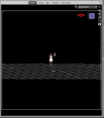

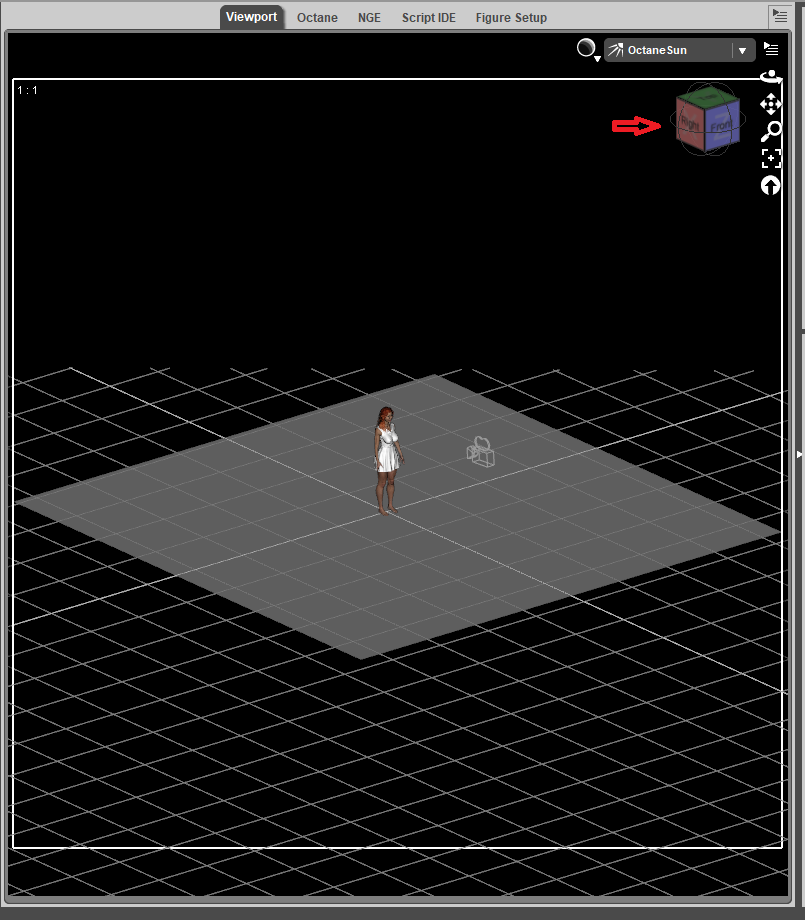

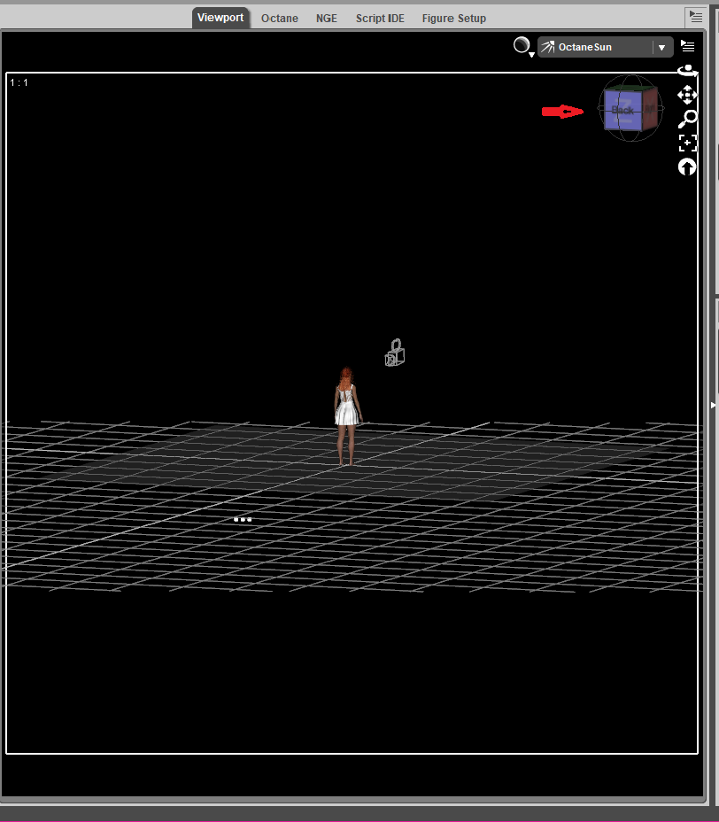

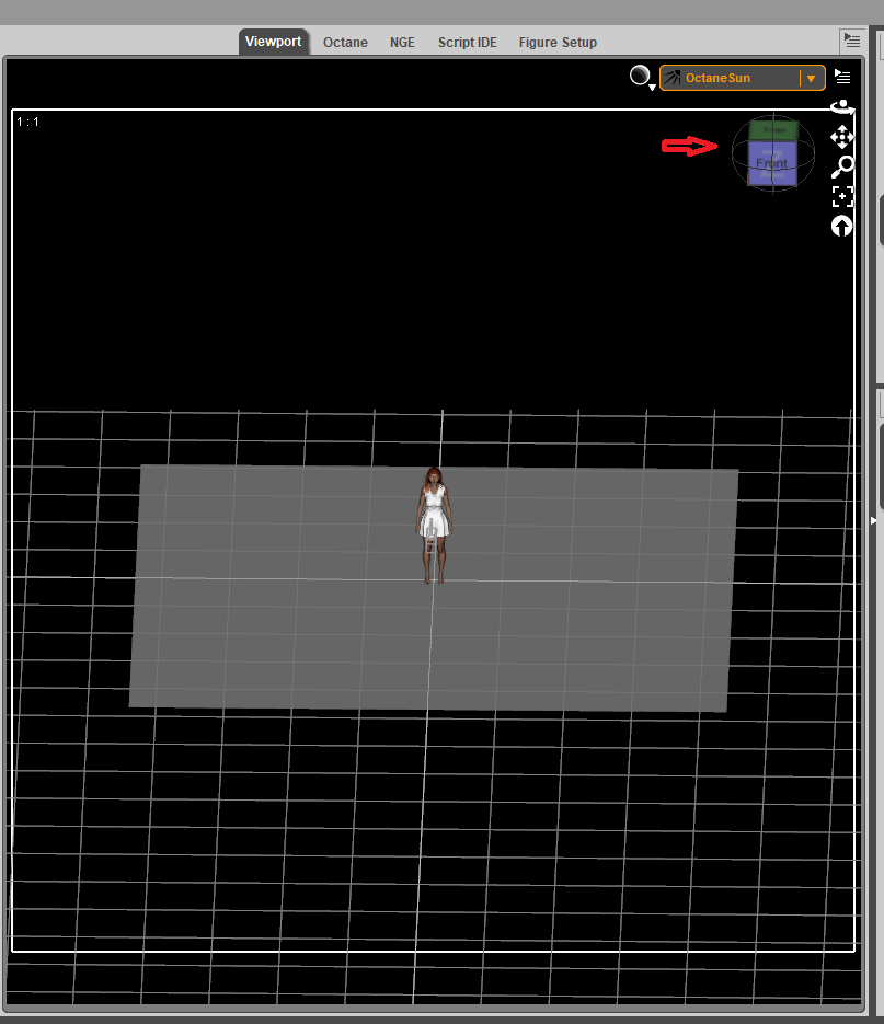

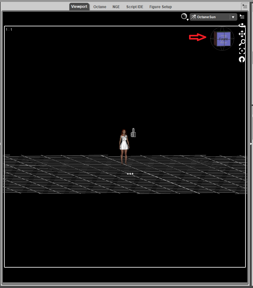

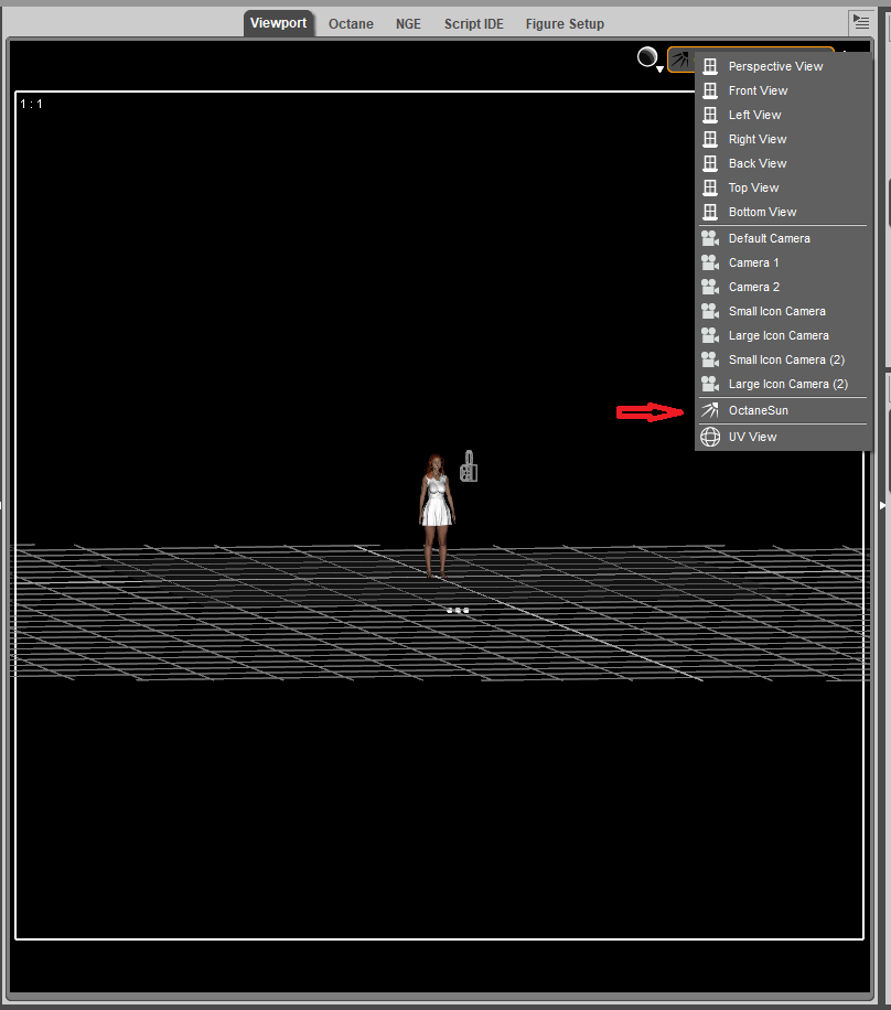

Btw. have a feature request. I had asked for this before using slider control but I think there is a better approach which should be more intuitive for us. Can you add a 'Octane Sun' (basically a distant light named 'Octane Sun') to a scene automatically and use its position to control the position of the Sun in Octane (Day light Environment) ? That would make it very intuitive for us to position the sun as we want it. We would select the 'Octane Sun' as the camera to position the sun as we would like it.
The plugin should be able to read the 'Octane Sun' distant light position and use that to place the Octane sun.
Add a distant light as 'Octane Sun'
Will allow us to select the 'Octane Sun' distant light and position it using the gimbal
E.g. high on the horizon
Or low on the horizon etc.
Position it from front or back or the sides, etc.
This will allow us precise control over the sun and allow us to light the scene in an intuitive manner.
Script for adding the Sun automatically - You can use this as a reference for the C++ code of the plugin:
(function(){
var OctaneSunLight = new DzDistantLight();
OctaneSunLight.setName("Octane Sun");
//OctaneSunLight.findPropertyByLabel("Intensity").setValue("0.8");
Scene.addNode(OctaneSunLight);
// Finalize the function and invoke

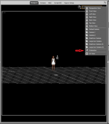

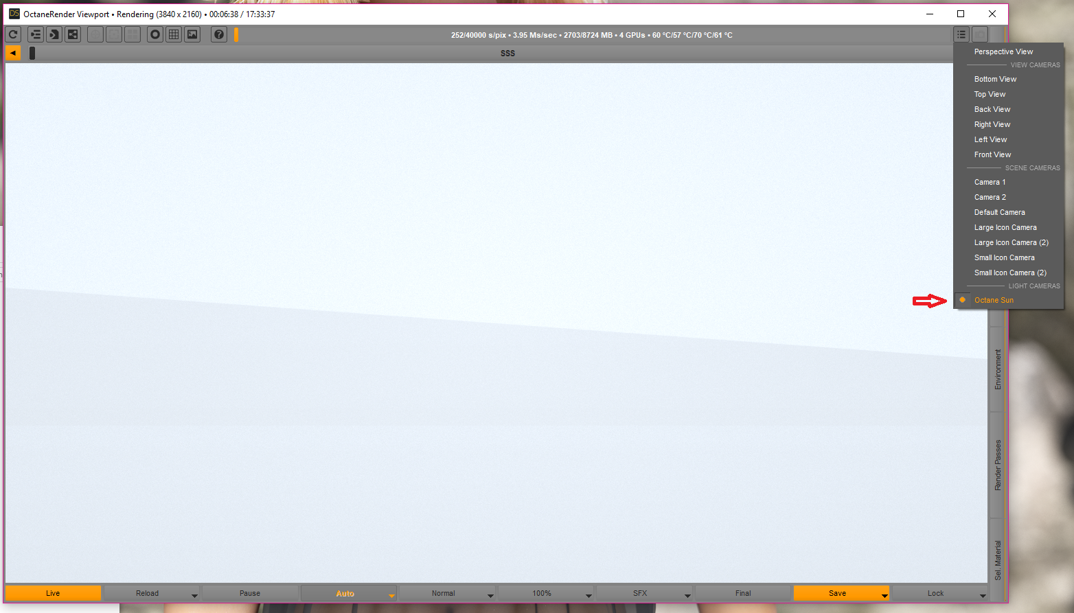

Octane Viewport does show this 'Octane Sun' under the 'Camera selection' as a 'Light Camera'. So I guess the plugin can already read any related properties and can set up the hook to update the sun position whenever the gimbal is used to change the direction of the 'Octane Sun' distant light.
Octane Sun as a Light camera appearing in the Octane ViewPort
Maybe under the 'Octane -> Environment Settings an option can be put - whether to use the 'Octane Sun' distant light or use the 'Sun Direction' settings. If 'Octane Sun' distant light is selected then the 'Octane Sun' distant light is automatically added and the position of that light camera is used to position the sun within the daylight environment.
