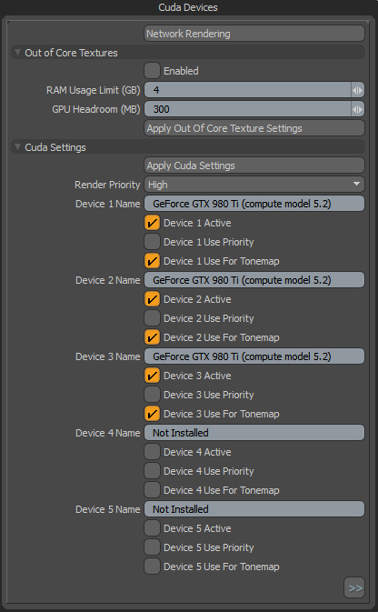

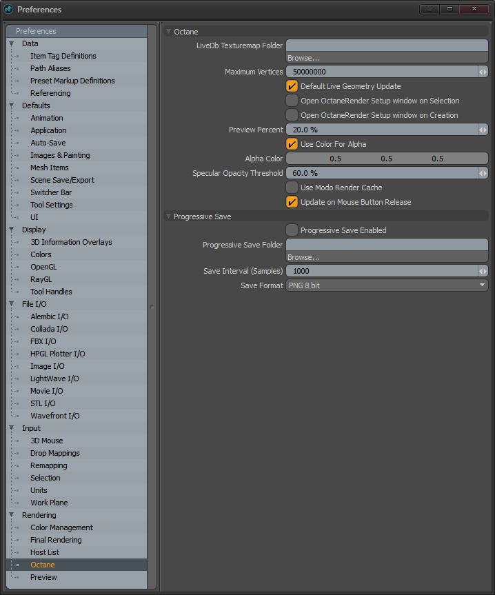

Dino - that scene is not crashing for me. Is it possible you are running out of VRAM - do you have OutOfCore Textures enabled? Can you post your System->Preferences->Octane panel settings pls?

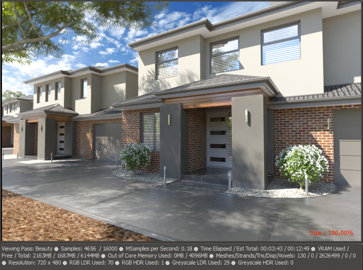

Vram looks good to me, plenty of overhead here:
Not using out of core tex:
Here are my prefs settings:

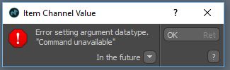

Hi Paul
I get this error every time I do view port navigation with octane when it asks me to "transfer the octane camera position to the modo camera?" and I say yes
It's been happening for a few versions now and I keep forgetting to mention it.
