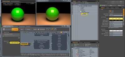

After some quick tests here is my idea for area lights.
When "create octane emitter" is pressed
1. Create the area light emitter geometry and add an item shader to it (same as octane does for point light). This helps us to compare modo to octane better
2. Use an octane texture emission (not a blackbody as it does now) with these settings:
* Octane Power = Modo Area light Radiance
* Octane Efficiency = 0.5 (or better 0.5 * light material color)
3. Octane diffuse opacity = 1 (So we see it in reflections. I tried matching modo visibility options, but the rules get complex and many dont match octane)
The match seems pretty close. What do you guys think?
UPDATE: I think I need to include light color too! I'll edit the above and also include a screenshot (of Efficiency = 0.5 * light material color)
UPDATE 2: I forgot to test if the intensity still matches when the lights are scaled. Glad to report it does.
UPDATE 3: I'm not 100% sure how to handle the light visibility. For now, I set the octane diffuse opacity to 1 so we can see the light in reflections

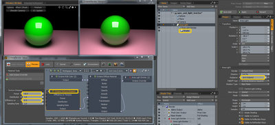

I often use luminous polygons instead of lights in modo, so I decided to see if we could convert them the same way.
Modo's material luminous intensity matches area light radiance, so we could convert using almost the same rules.
If I have a 1m x 1m plane (matching an area light) with luminous intensity > 0
* Create the same node setup as the area light (octane texture emission plugged into a diffuse material?)
* Octane Power = modo luminous intensity
* Octane Efficiency = 0.5 * modo luminous color
* Octane diffuse opacity = 1 (So we see it in reflections... right now the plugin makes area lights invisible)
It ends up looking very similar to the area light screen shot I posted
This means we should be able to do "on the fly" conversions of luminous materials, without the need for an octane override
