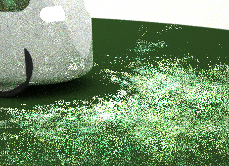

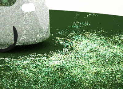

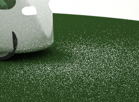

2.there is something going on with specular materials given scattering and emission.
see attach not clearing up getting worse.. ground is diffuse btw

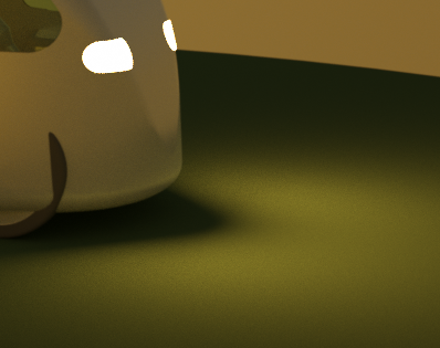

- for comparison
correct light pattern in evening - test diff emit.png (161.77 KiB) Viewed 2584 times

Hi,pixelrush wrote:2.there is something going on with specular materials given scattering and emission.
Subsurface scattering in specular materials will clear up very slowly or not at all when using very small or distant light sources. In these cases a material with diffuse transmission will work better.
Roeland
if you say so but I think its broken atm or it seemed to be - just got more and more snow on the ground
I am not sure people would use this combo, sss+emit, but I tried it and it didnt seem right, dunno.
I think we have seen a case of unseasonal pixel fall once before.... could be wrong though
