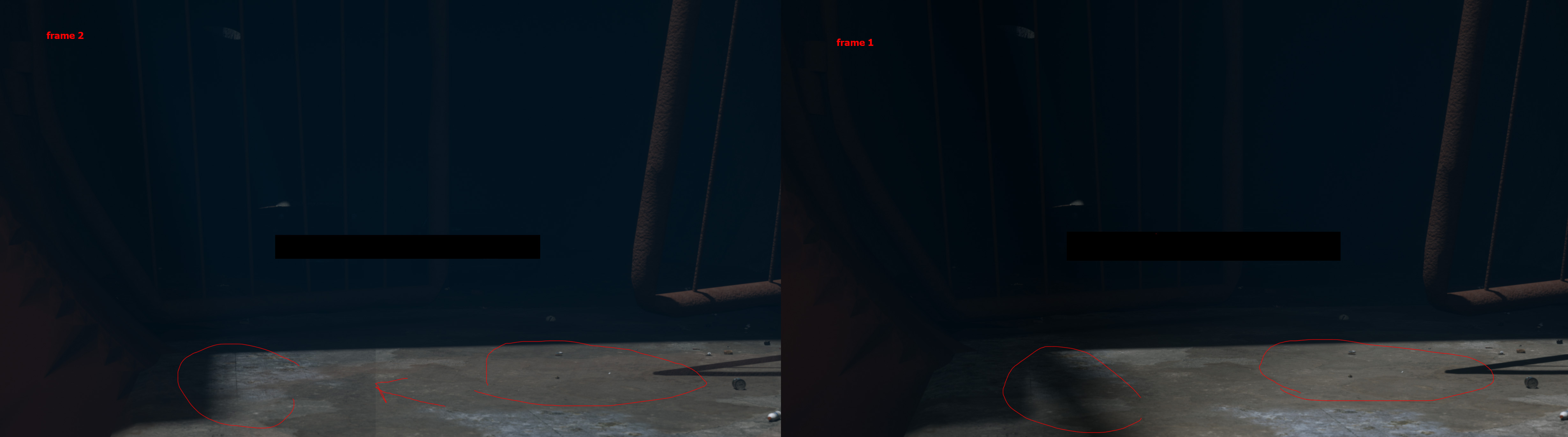

This version is strange. Sometimes itoo won't render for the first frame, sometimes the screen flickers only one side (maybe coherent option issues or network rendering).
In the image attached (frame 2) the concrete floor circled on the right has strange diagonal lines.
Unfortunately, I cannot share the scene. Hopefully you'll find the bug.
Opening octane viewport and then rendering again fixed it.
I wonder if slaves don't contribute correct rendered data.
PS A lot of the times we have to go to support>refresh itoo legacy forest. Otherwise it wont render. Direct forest is too slow at evaluation each frame.

paride4331
Posts: 3935
coilbook wrote:This version is strange. Sometimes itoo won't render for the first frame, sometimes the screen flickers only one side (maybe coherent option issues or network rendering).
Hi coilbook,
Could you perhaps partially share the scene with the simulation containing the error by sending me a private message?
Regards
Paride
paride4331
Posts: 3935
Hi coilbook,
try checking the 'minimize net traffic' and 'static noise' options in your Kernel panel.
Regards
Paride
