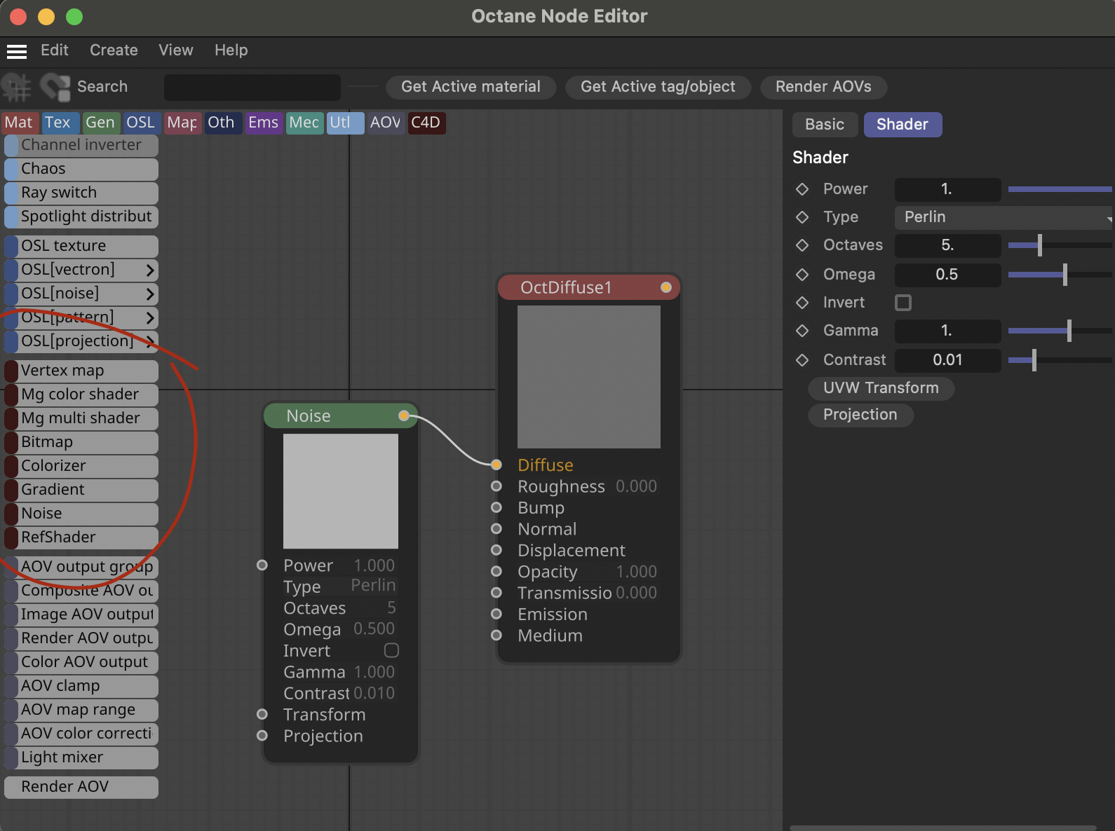

When I use these nodes the computer freezes.
P.s. I use c4d R2023 & apple M1 max

nipper127 wrote:When I use these nodes the computer freezes.
Yes please, avoid to use any C4D Shader with M1/M2 chip.
The core devs are fixing an issue in SDK for next version, that should solve the issue.
You can replace the C4D Gradient shader with the new Octane Gradient Generator node:
And the C4D Noise shader with new Octane Noise4D node:
