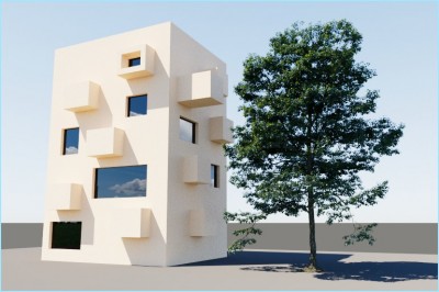

Orginal :
ACES :

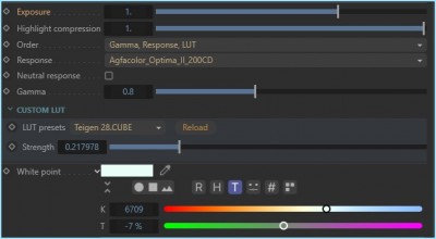

Camera Responses, Lut's, Exposure, Gamma, White Point magic all inside Octane :

Magic in Octane :
Response_Lut.zip
(642.31 KiB) Downloaded 113 times

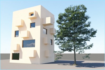

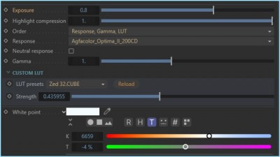

Aces simulation with Camera Response + Lut :
Agfacolor_Optima_II_200CD_Zed_to_Aces.zip
(277.33 KiB) Downloaded 98 times
Left -> Camera Imager, Right -> ACES
Near 98% the same blue and green tint using Teigen28 cube but different settings :
