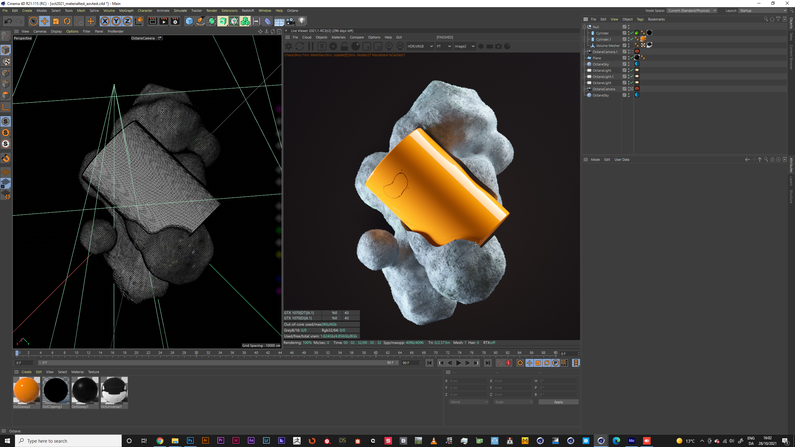

Is there any way to avoid this intersection issue, happening when non clipped objects (higher priority material) intersects with the clipped object?
jayroth2020
Posts: 495
Joined: Mon May 04, 2020 7:30 pm
Mike, Cinema 4D's booleans (any polygonal booleans, actually) can only do so much, and, from a topology point of view, they can create as many problems as they solve. I was very excited to see that we have added the Clipping material, and it has met my expectations, but I realize that I have to give it good data in order to get a good, predictable result. That is true for any engine, as I mentioned. Good topology is a requirement across the board for the best results. I feel your pain regarding the CAD data; I usually see only garbage from CAD systems, for the most part. The few times that I haven't had to clean up something was a joyful experience.

Try adjusting the Ray Epsilon value either higher or lower than what you have currently. That should do the trick.

Hi jayroth,
adjusting "Ray Epsilon" I had already tried because these artifacts look like typical Ray Epsilson problems,
but unfortunately that did not work in my case.
By the way: Clipping material is really a great thing, which works very well with normal objects!
That it hooks with complex CAD data, o.k. you have to live with that.
But I do not need this kind of operations too constantly. For this job, I will correct this in AE.

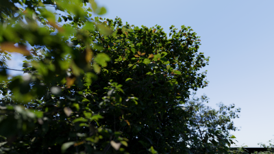

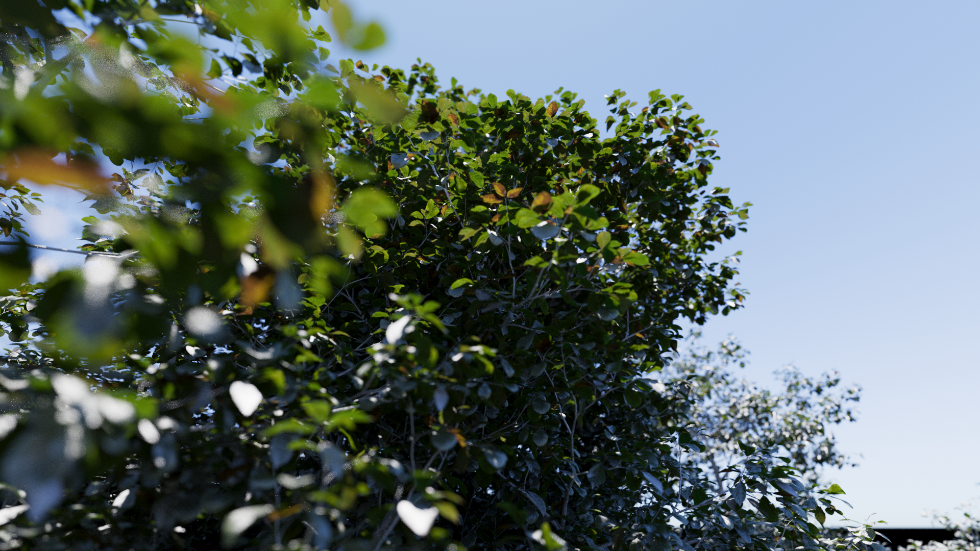

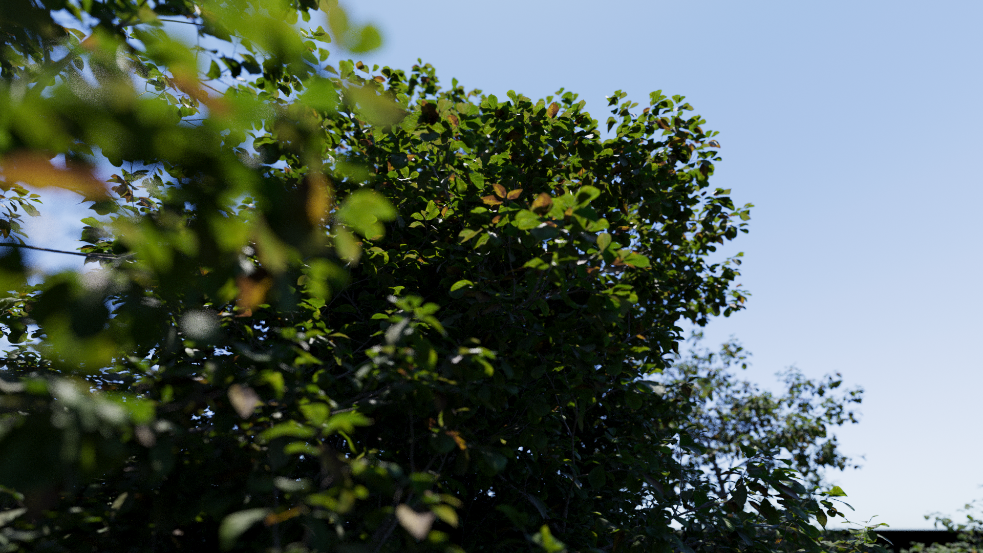

SO exciting to see the stable release of 2021 standalone. I have a quick note (hopefully) that can make the c4d release (if it is indeed a plugin issue not a core issue)..
I mentioned this a few months back in one of 2021's initial builds, but it seems to of been missed (totally ok!)
Essentially when you have an object in a scatter with multiple materials (trees for instance), as you move the camera around certain/random selections/materials will periodically flicker/cycle/turn on/off etc.
Attached is 2 renders, where the ONLY difference is the camera is 0.001m different...as you can see this will become extremely problematic with anything animating as the materials will break.
Ive only tested with foliage/trees, but this doesnt happen in 2020 at all obviously. No matter the tree (Forester/speedtree/fbx/anything) it is pretty easy to replicate.
Let me know if this makes sense!
AW

AaronWestwood wrote:Hey All,
AW
It doesn't make much sense without reproduce it on my PC. There may not be any issues on plugin side if you just move the camera. Please give better data and information.

Thanks for you reply Aoktar. Find below a link to a C4D project where I just quickly replicated the issue.
https://www.dropbox.com/s/eyexfrq22pd0v ... A.zip?dl=0
The camera is setup on a 'problematic' frame where textures are bugged (in this case they are 100% white on some selections) so you should notice this straight away. If you move the camera you will notice all textures return. Let me know if this now makes sense...?
