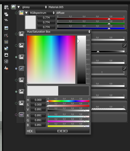

bug when adjusting colour picker value- see attach pic.
RGB value in picker is not consistent with the inspector one except at 0 or 1.
