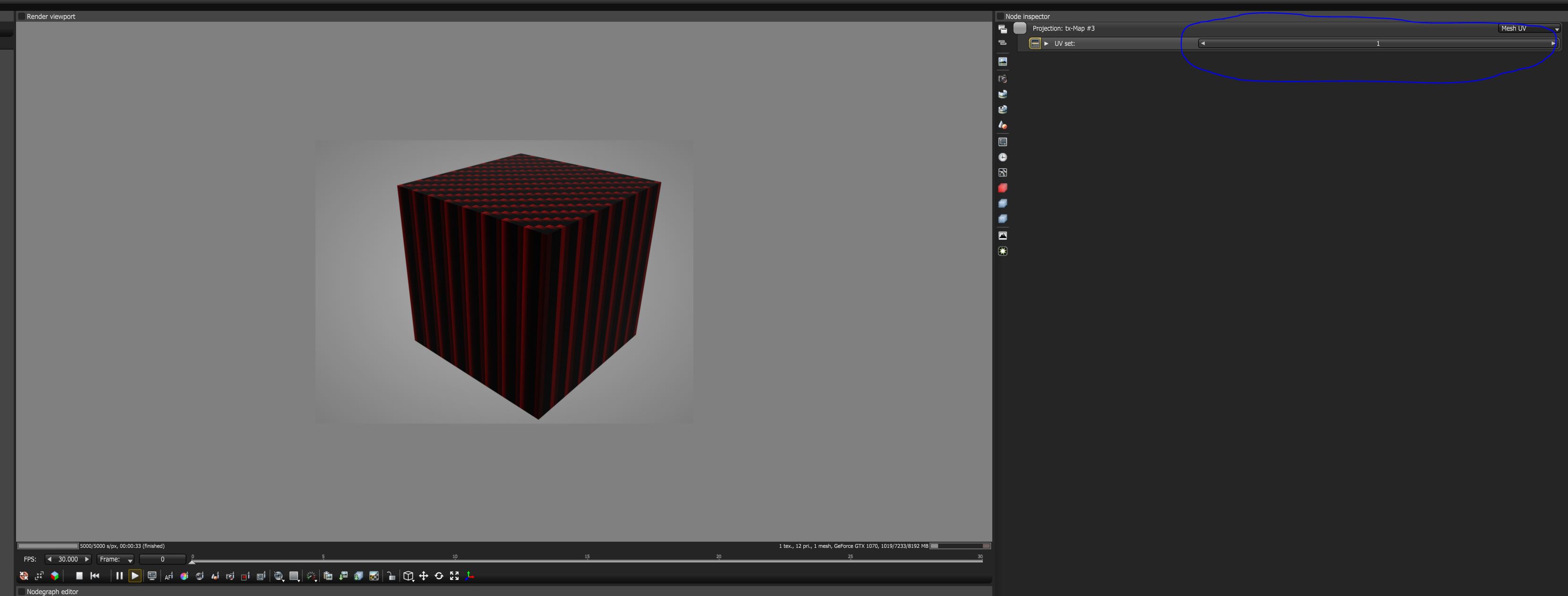

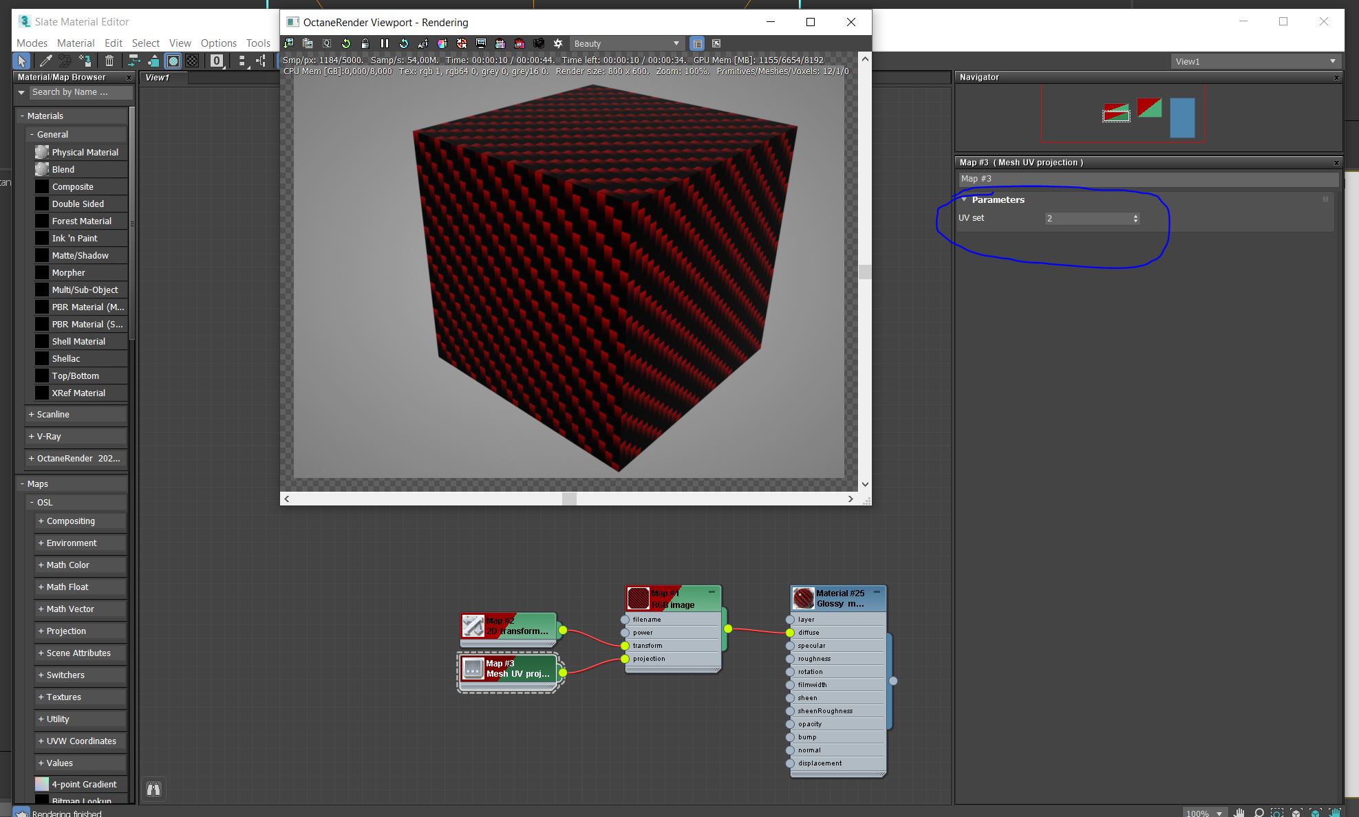

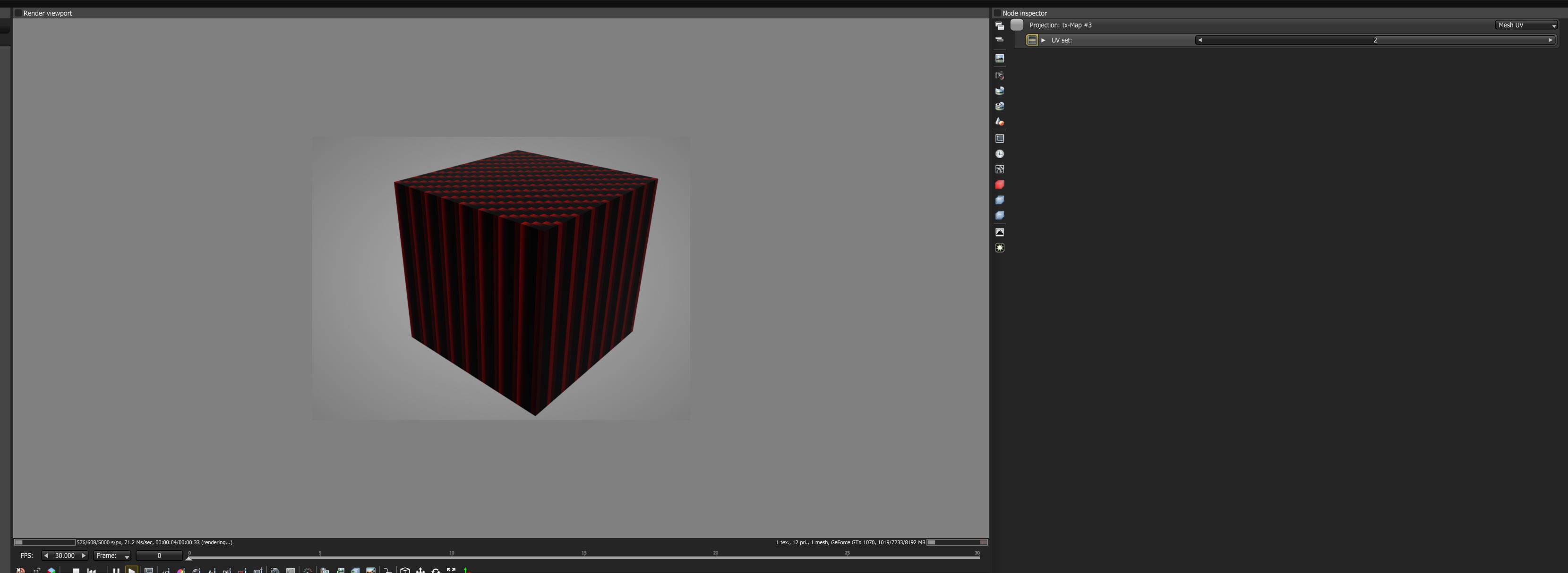

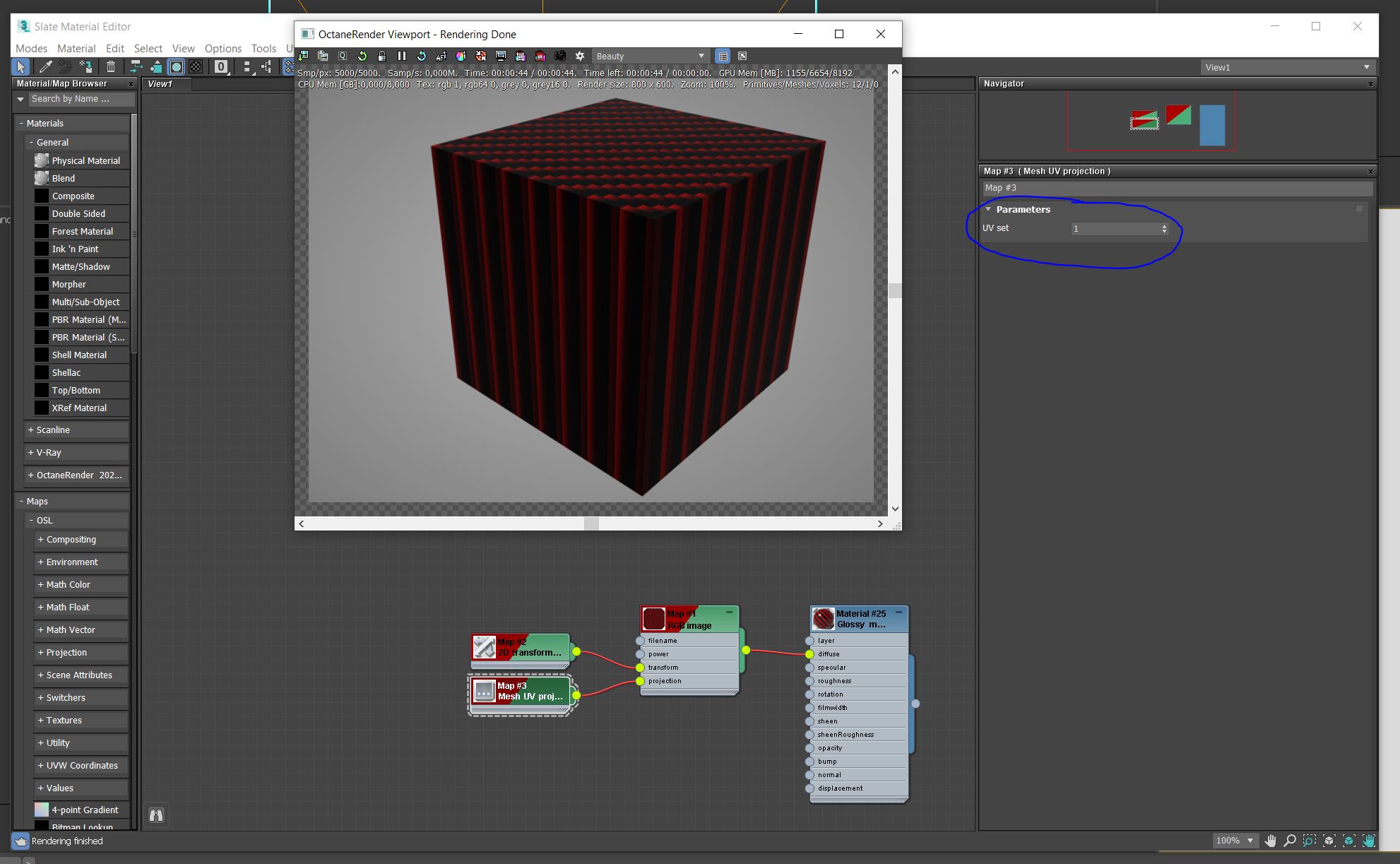

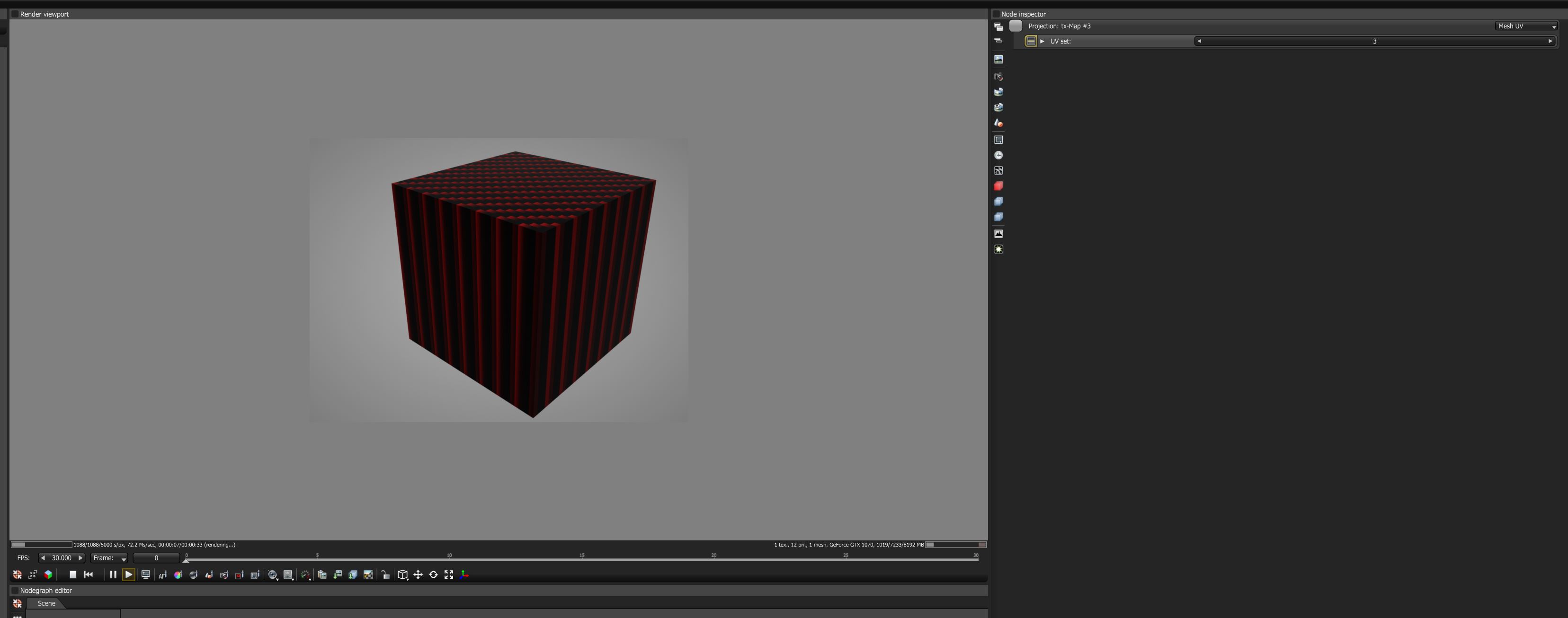

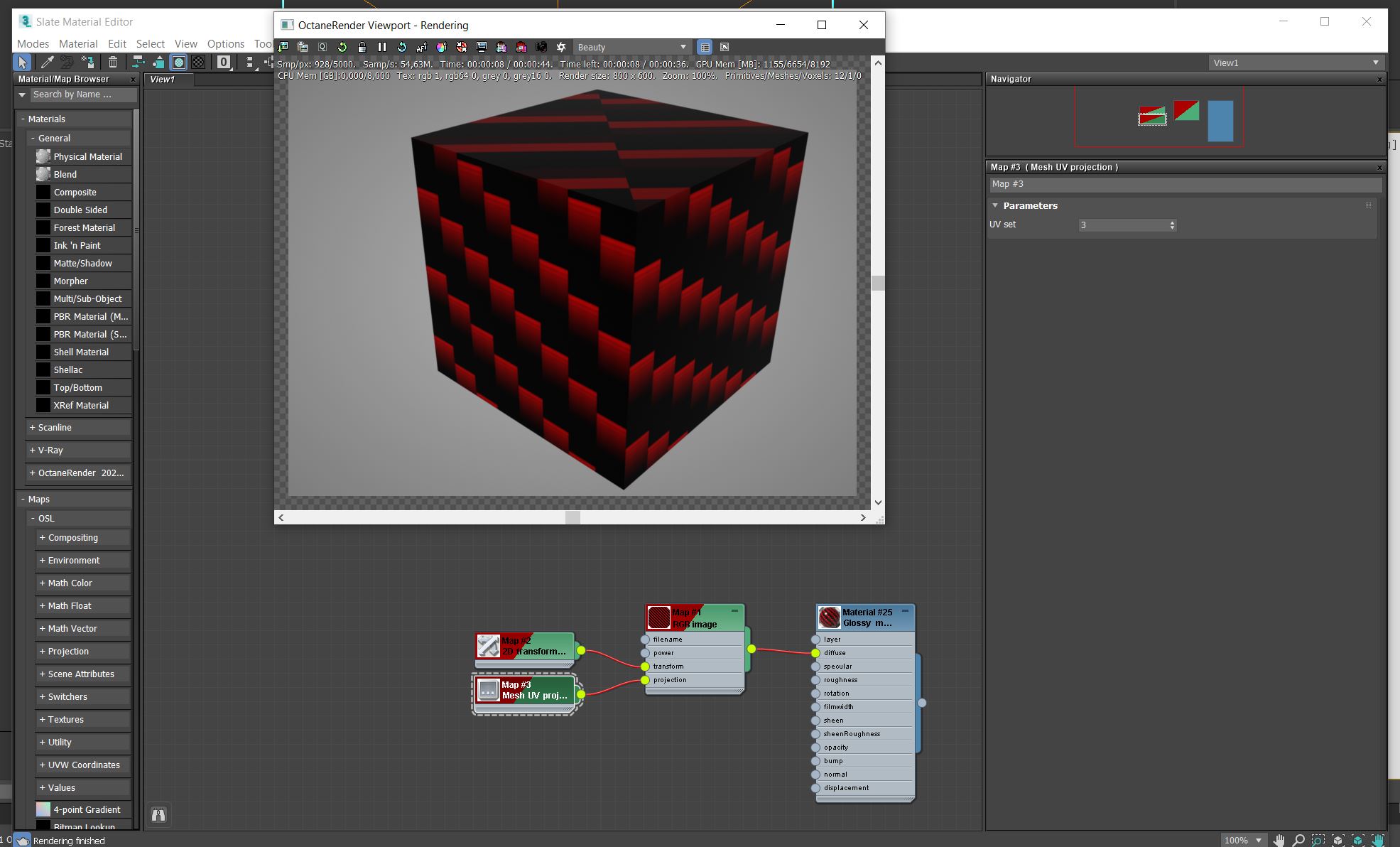

Hi Paride,paride4331 wrote:Hi Nick73,nick73 wrote:Hello,
I don't know if this is a bug of the plugin.
Using different values with Mesh UV Projection works fine in 3ds max. But when I export the object as orbx and open it with standalone, changing the UV set doesn't affect the mapping. Octane seems to ignore it and uses only the default value.
Thanks in advance.
are you referring to material UV transform? It seems to work.
Regards
Paride
First 3 pictures are with 3ds max 2020 with Mesh UV set to 1,2,3
Then I exported file to standalone and:
I can sent the files as well

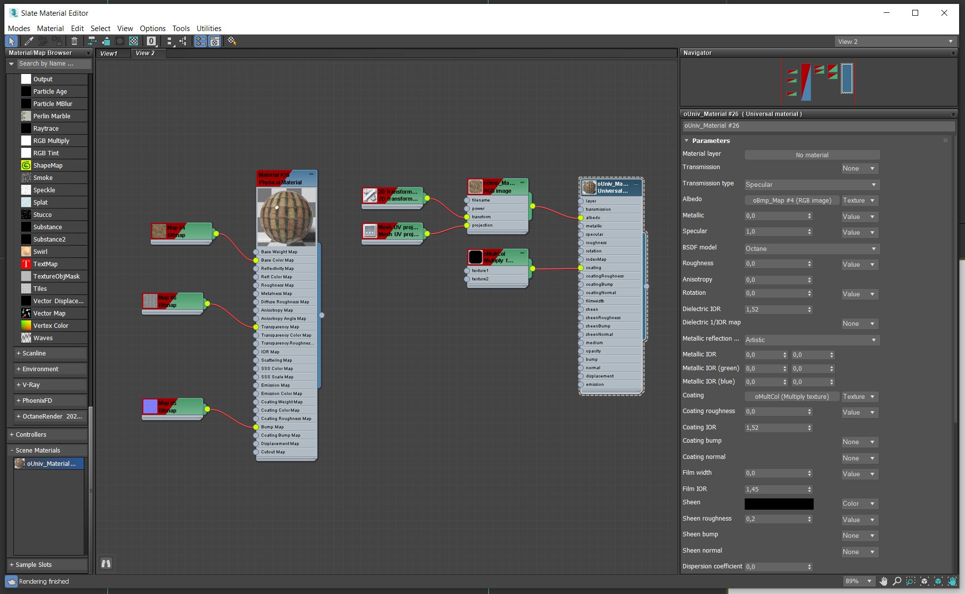

Hi Paride,
Converting materials has been broken in 10.19. Previous release did convert normal map and I should only toggle it from bump node to normal. Now It's missing at all. I guess I preferred as it was before. Another thing, I believe the script should convert transparency map into transmission node with a gamma of 2.2. I am using this all the time with good results.
Thank You.
Thank You.
