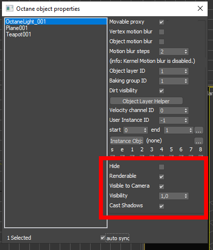

Did you set movable proxy as default in Octane global preferences > main setting?
New Octane properties option in the next plugin release would help your needs.
