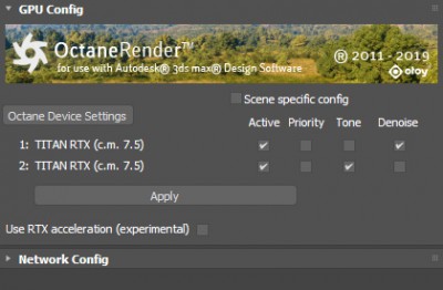

try changing which card does the denoising?
I had to put 1 card on render duty and another on denoising.
Actually I now have 2 2080ti doing the rendering and 1 old 10606gb doing the denoise. Working great so far...

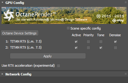

mbetke
Posts: 1304
Location: Germany
I use this configuration. One denoises. The other ones tones. Both render.
PURE3D Visualisierungen
Rik
Posts: 423
Joined: Wed Jul 28, 2010 8:57 pm
Apart from it being slower, does it work if you untick the active box for the card which does the denoise? So 1 card does the rendering, the other does the denoising?
