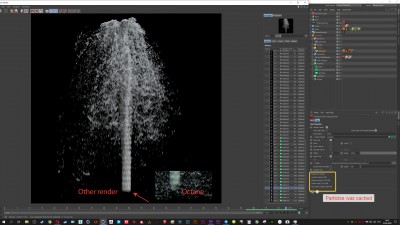

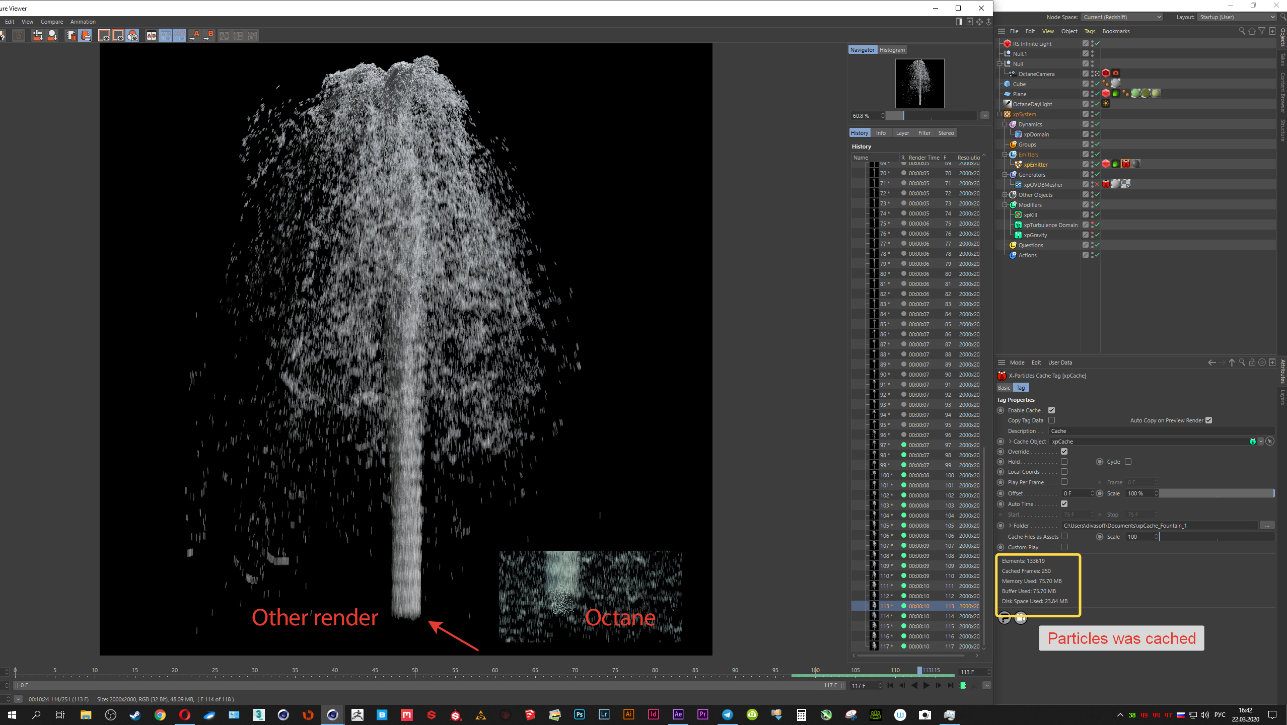

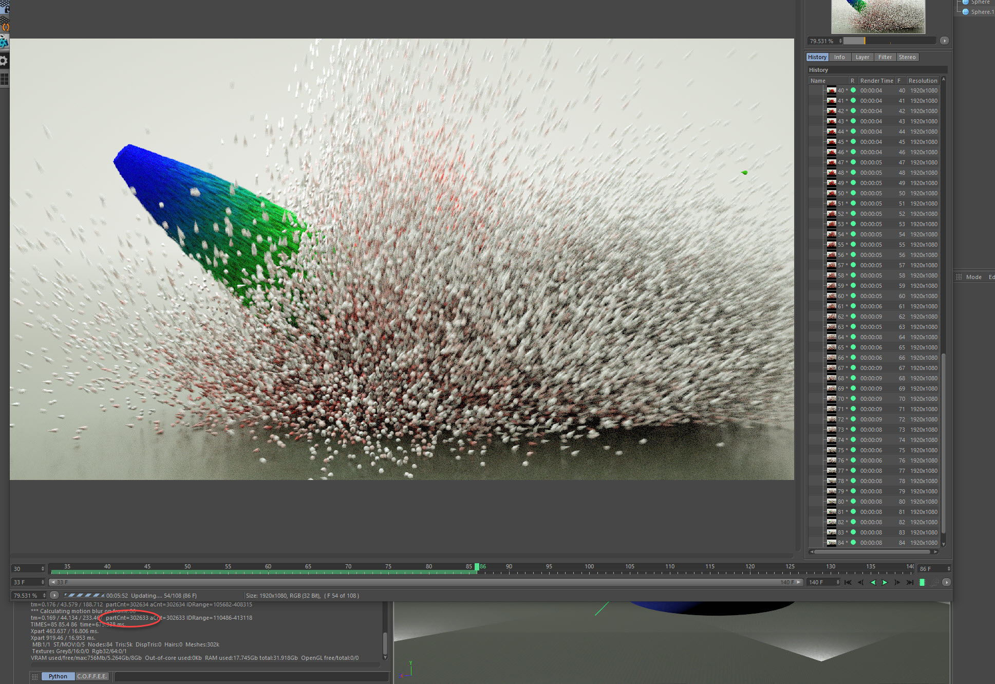

Sorry guys, but again I am with my problem with motion blur. Impossible to render.
I have to sit next to the computer all the time and restart the render every 10 frames, otherwise the calculation time for motion blur, even in the simplest frames, reaches tens of minutes.
This is a basic problem that had to be solved many years ago. This is one of the main functions of the engine. I absolutely do not understand how you can ignore it.
divasoft
Posts: 349
Joined: Thu Jul 01, 2010 3:59 am
Location: Russia

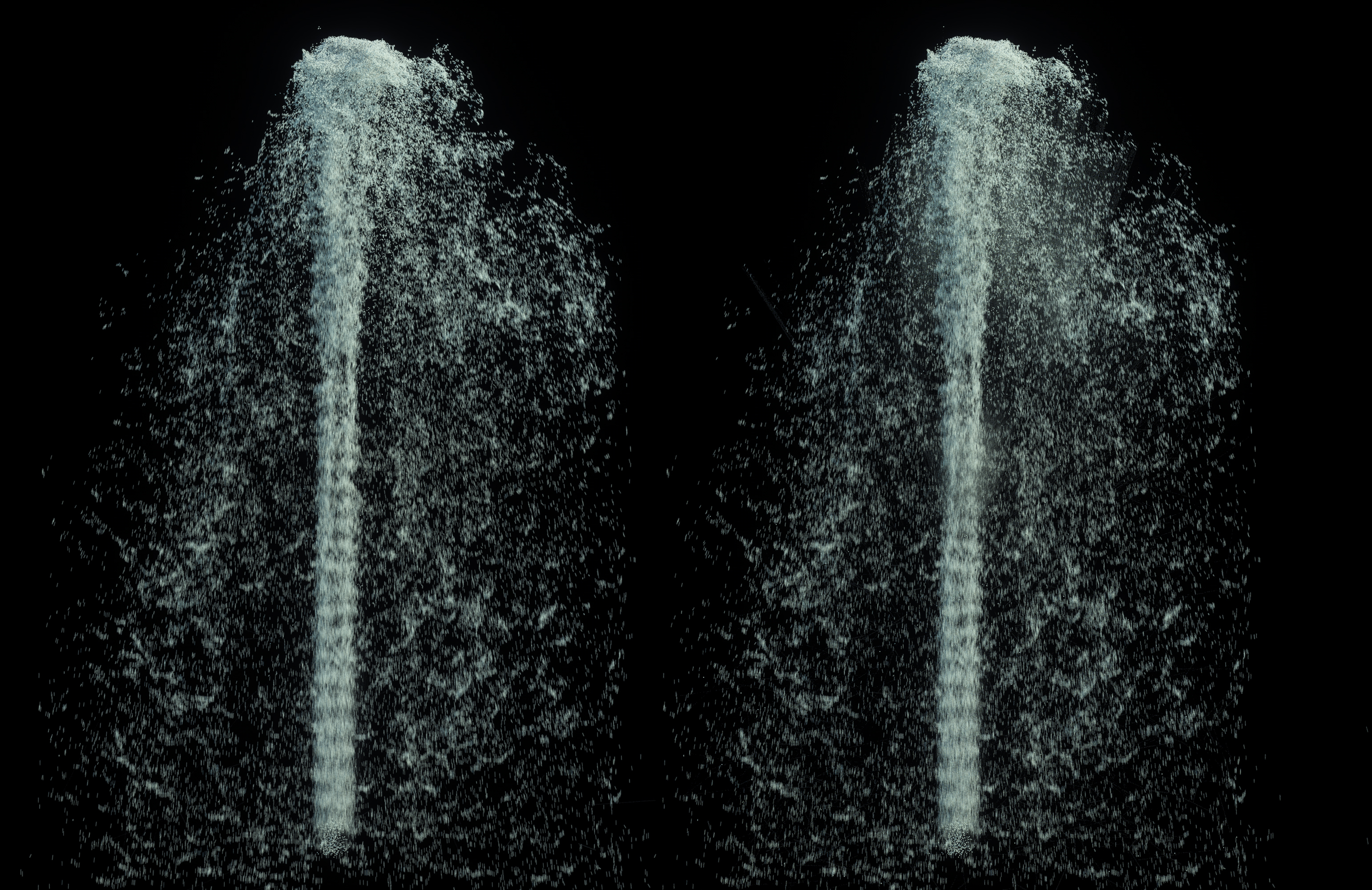

Plus, the same frame is different if I restart the render. As a result, I cannot completely use motion blur, because if the frames after the restart are different, I will get a glitch when I make the sequence.
This is a very serious problem. Great new features are very good, but the basic functionality does not work.

divasoft wrote:Plus, the same frame is different if I restart the render. As a result, I cannot completely use motion blur, because if the frames after the restart are different, I will get a glitch when I make the sequence.
Sorry but have checked with standard renderer before critise? And did you cached the dynamic?
divasoft
Posts: 349
Location: Russia
As you can see, this problem is solved in other renders or it didn’t exist there from the very beginning. Rendering time per frame is increasing, but gradually with an increasing of particles and not exponentially. Moreover, t’ there are no artefacts in the particles that has been just created. And yes, particles was cached.

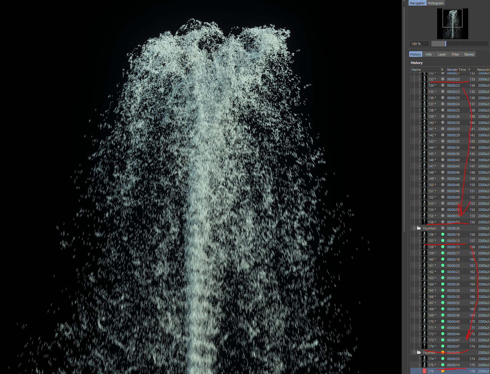

divasoft wrote:Sorry guys, but again I am with my problem with motion blur. Impossible to render.
I found some fixes to improve performance with high emission amount for xpEmitter. Here's a screenshot from render times. Please do not claim I'm ignoring anythings for next time, it doesn't sounds fair and well. I have a lot of different tasks to improve this plugin. All takes so much time until they are stabilized. I'm still working on problems and missing parts of group feature for example, also making small fixes and bug hunting.
This is awesome news, thank you very much for your work :o
