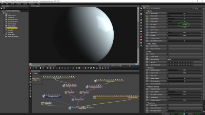

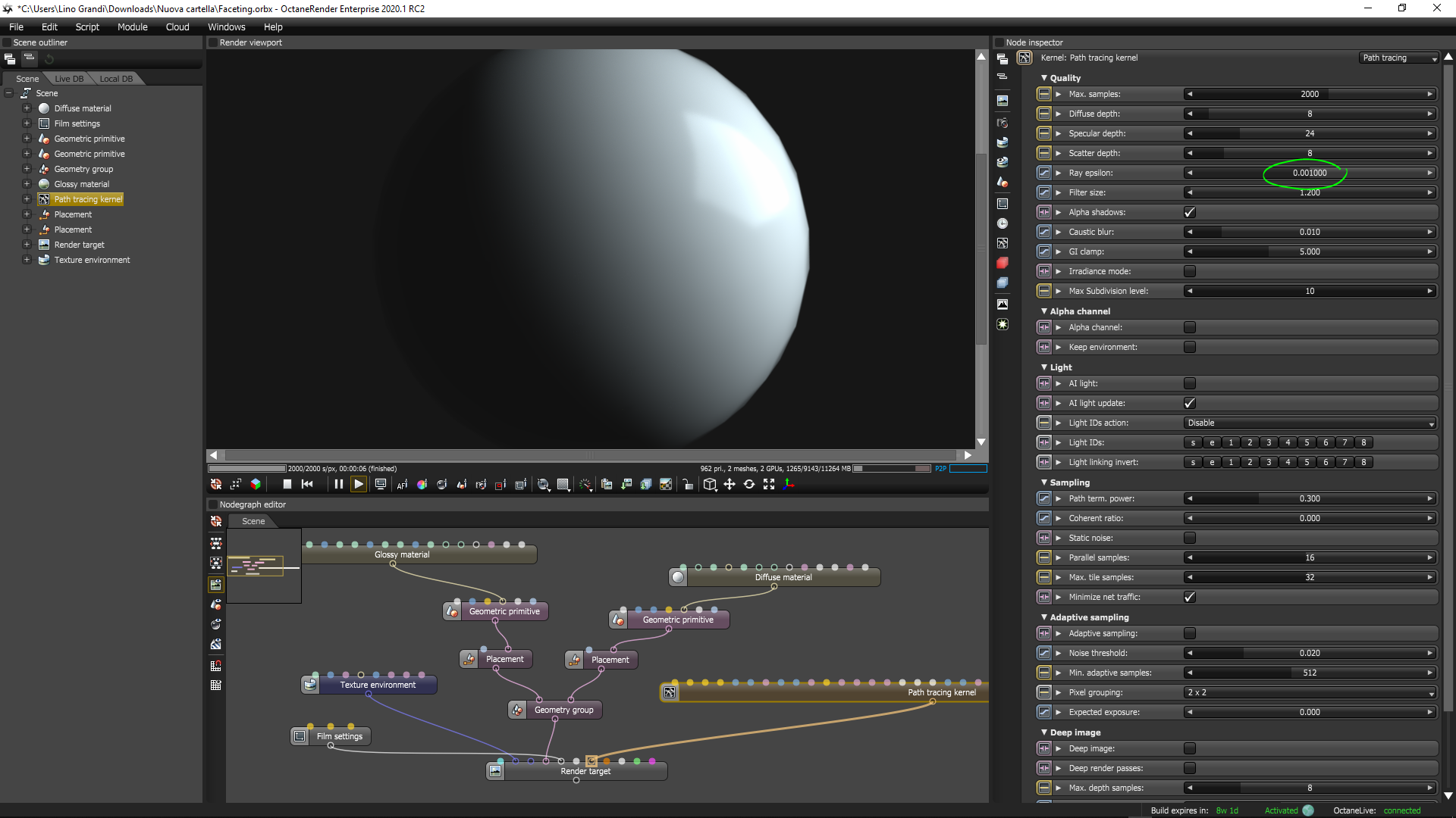

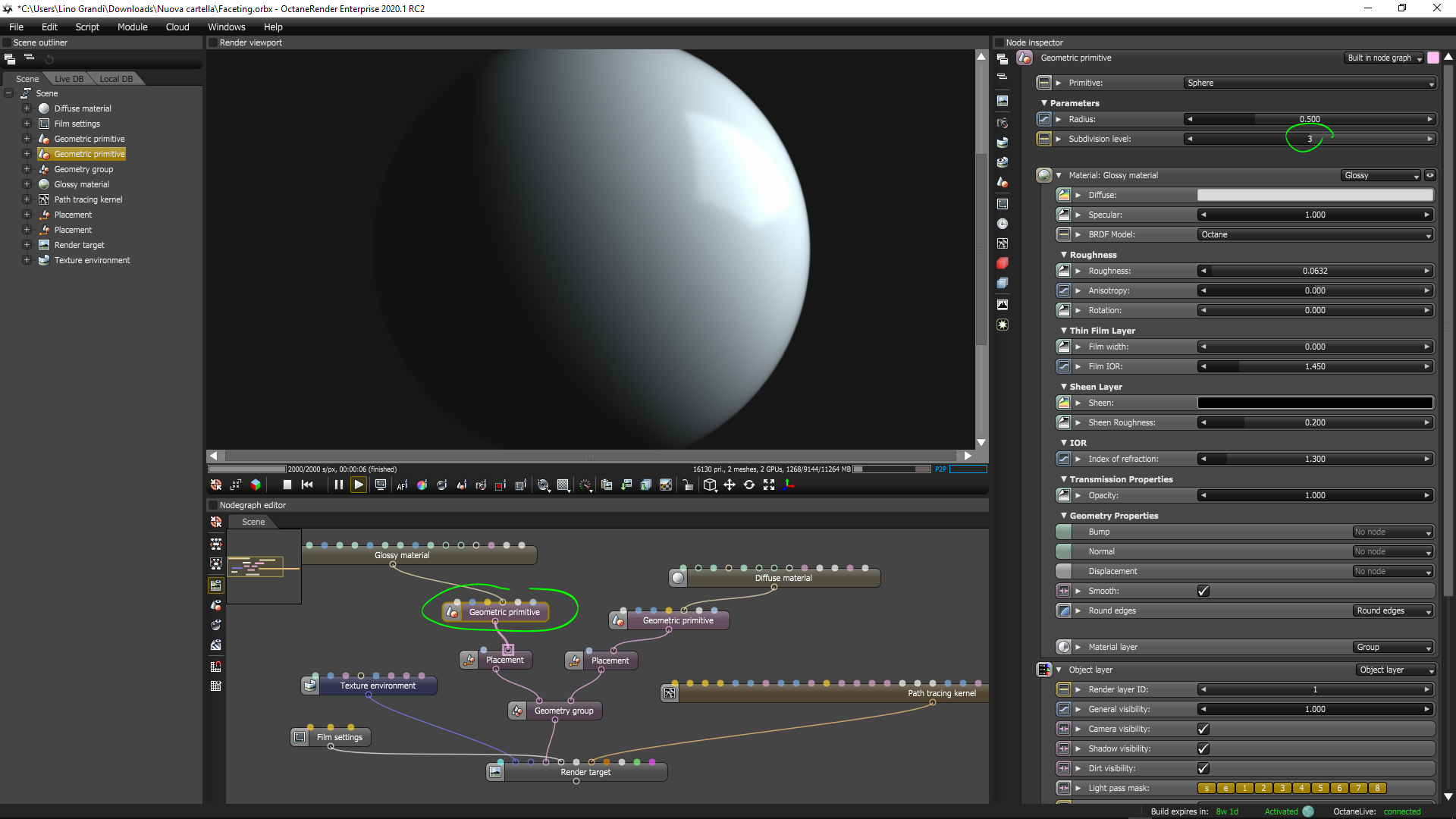

You should increase the number of subdivisions in the primitive.
Changing the value of Ray Epsilon can also help:

Like i said, i dont always want to increase subdivision because of performance reasons. Increasing Ray epsilon helps, but on characters with geo shells or other very close surfaces you will get artifacts.
Both ideas help in certain scenarios but arn't final solutions, atleast in my opinion. To me this appears to be a bug, dose it?

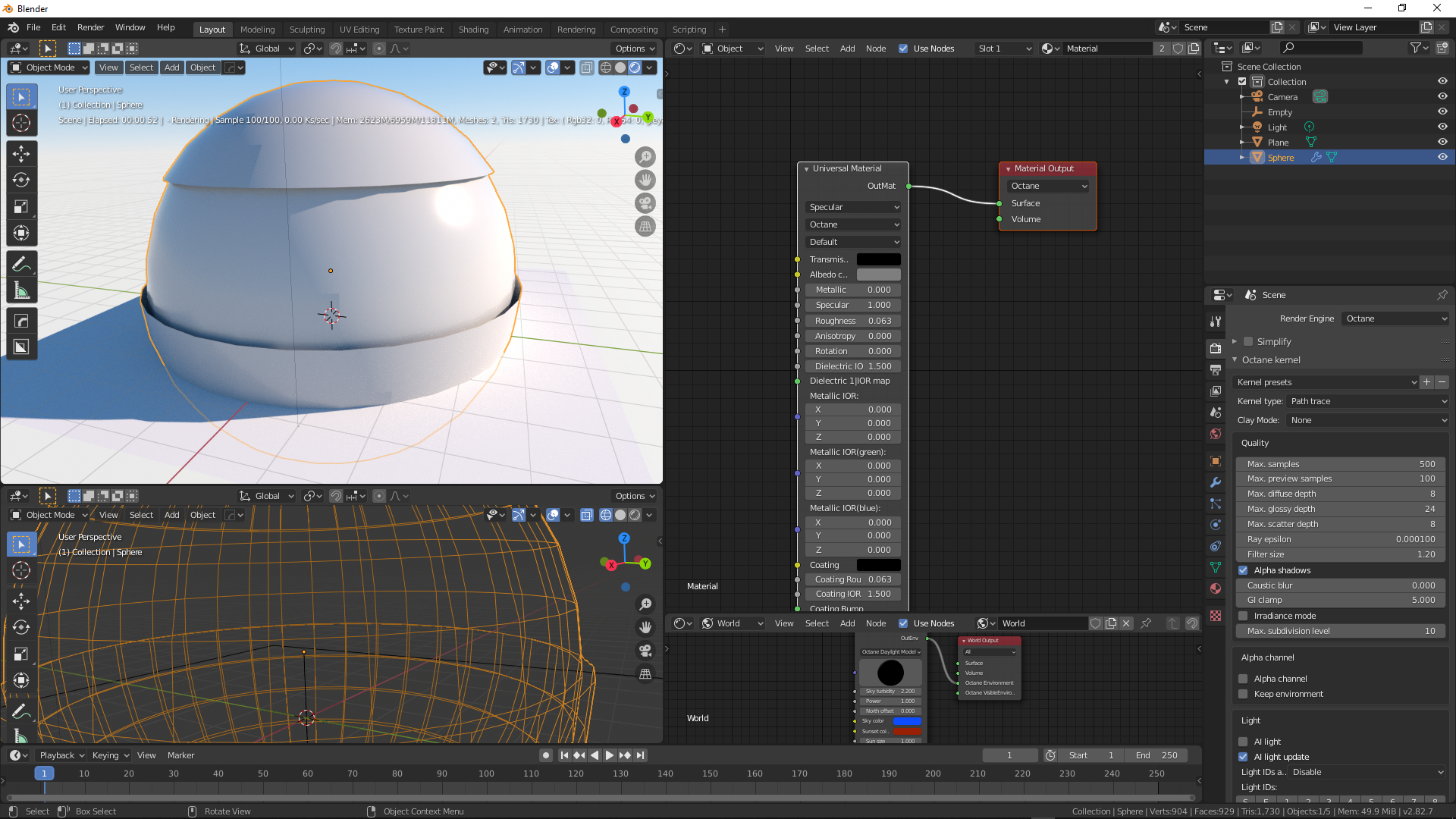

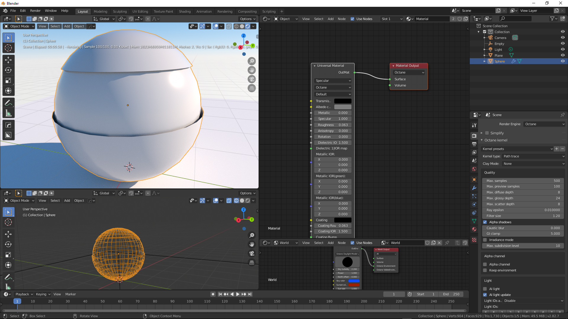

Kanne wrote:Like i said, i dont always want to increase subdivision because of performance reasons. Increasing Ray epsilon helps, but on characters with geo shells or other very close surfaces you will get artifacts.
Well, no, not a bug. That's the way most renders work. OpenGL works differently. Adding subdivisions is important to get rid of artifacts when using a path tracer.
Ray Epsilon works quite fine, even when you're dealing with close geo.
That's the same scene with the default Ray Epsilon value:

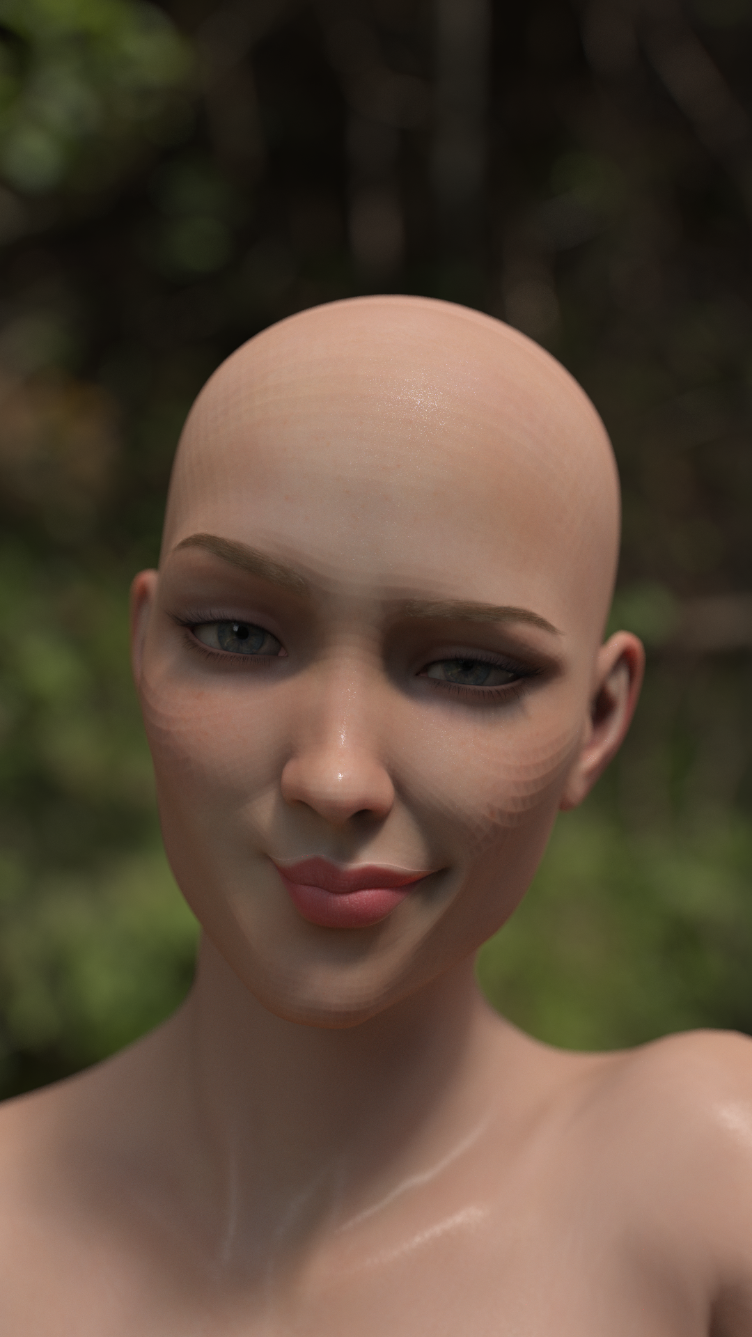

The problem is not the sphere itself, i just used it as an example for a small orbx filesize.
My main issue is a character i try to create a shader for (download/file.php?id=78427&mode=view) From my expectations i thoughed the mesh would be high-res enough. But with high density scattering nodes it seems to become even more visible, like i described in viewtopic.php?f=44&t=73989.
