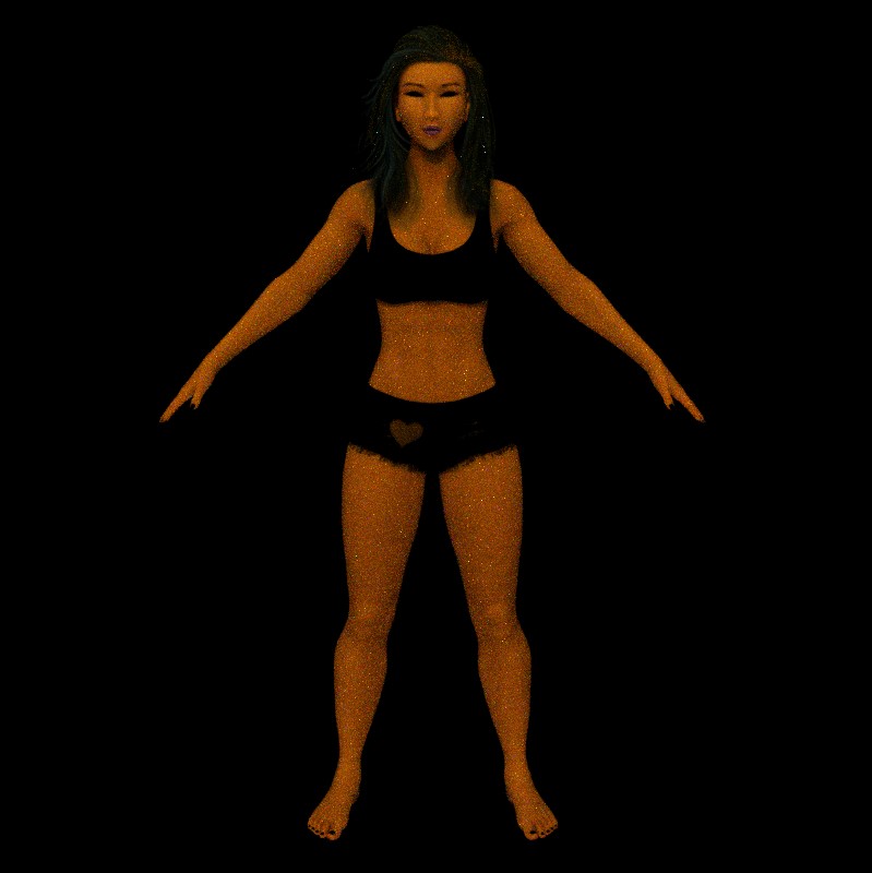

Hi Otoy Team,
Another issue that has been highlighted before is the seams appearing in the SSS / main render at the UV edges. This is was not there in 2019.1.5. I open the same scene in both versions (2019.1.5 & 2020.1 XB3).
In the 2019.1.5 as you can see there are no seams in the SSS render pass.
2019.1.5 SSS - No Seams

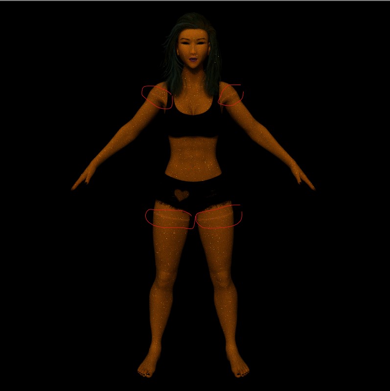

But in 2020.1 XB3 the seams are still appearing at the UV edge (like it did in XB1 & XB2)
2020.1 XB3 SSS - Seams at UV edge
Hope this can be resolved soon.
