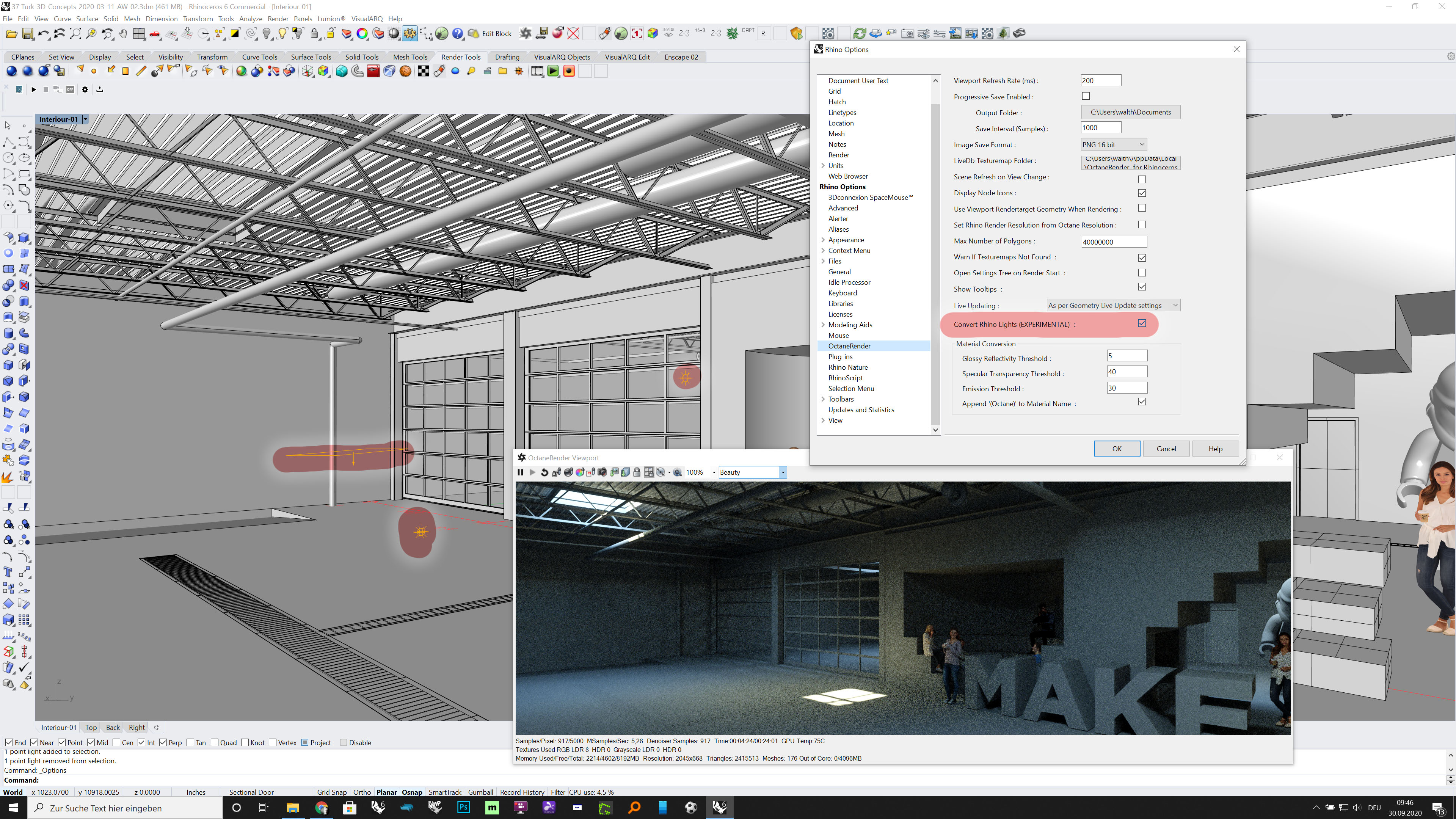

Hi Paul, I cannot get the Rhino/ Octane light conversion to work to work...
Can you send me the scene please, and I will take a look.

Hi Paul,
It (somehow) works now but I had to lower the environment / sunlight to almost 0 before the rhino lights came to life...
Maybe we can have a kind of global multiplier for the lights ?

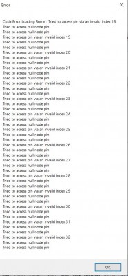

Hi Paul,
what does the errors:
"Cuda Error Loading Scene Tried to access pin via invalid index 6
Tried to access nusll node pin" mean?
Just merged 2 Rhino scenes via import and now got the error.
Using Rhino 6 on Pc / Win 10 with Octane 4 Rhino 2020.1.4.122
Thank you
Cheers
Nando
Hi Nando. Can you please update to the latest version of the plugin, and if it is still happening there, please send me the scene.
Paul
Are you able to send me your scene please?

Hi Paul,
thank you. I have tested the latest Plugin Version, which shoed the same errors, and on top of it the render view remained gray (not starting the render).
Unfortunately I can not share the scene, that came from a client.
Could it be a problem with blocks or some faulty material connections?
Best Regards
Nando

Just for anyone running into the same issue (see post before).
It seemed that the "invalid pin error" came from faulty block materials. I guess the "convert all materials to Octane materials" does not work properly with blocks, but I would need to investigate this in detail to be sure. Reassigning a new material on the block child fixes the problem.
