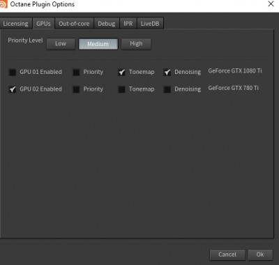

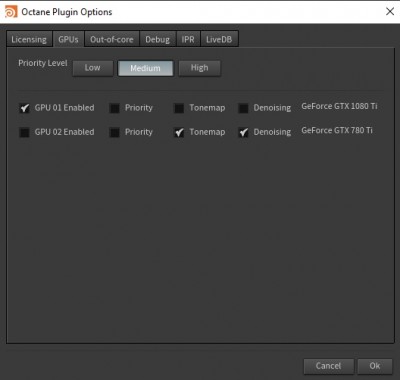

WoutTgh
Posts: 182
Joined: Sat Jul 27, 2019 8:39 pm
Oh, this is interesting. With these settings, the render starts but does nothing, no progress..
WoutTgh
Posts: 182
Same thing happens with these settings:
juanjgon
Posts: 8867
Location: Spain
You need to enable the tonemapping in at least one of the GPUs used for rendering.
Thanks,
-Juanjo
WoutTgh
Posts: 182
I see, haha, well that explains that then :)
