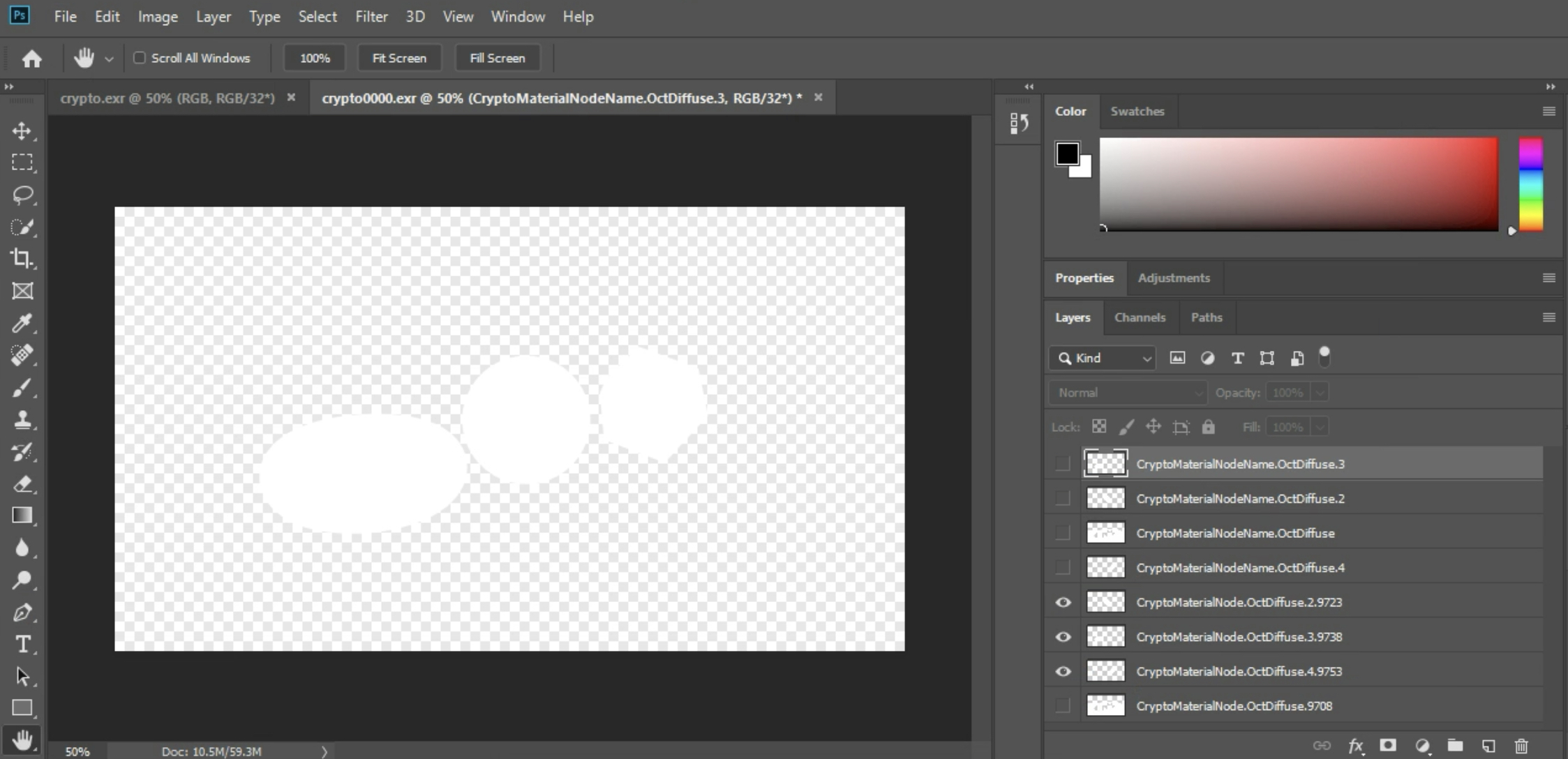

I have massive problems with Cryptomattes in 2020.1.4. I rendered frank's file here and as soon as I want the multilayer EXR in PS I get the message "No cryptomatte layers in file". On another rendering I have the transparent issue mentioned above. Is there sth broken or am I missing sth.?
Crypto_renderings.zip
(9.88 MiB) Downloaded 236 times
3080ti
Posts: 10598
you need to use EXR-io to be able to see and use Cryptomatte passes in photoshop:
https://www.exr-io.com/
ciao Beppe
ceen
Posts: 114
Joined: Wed Jun 10, 2015 9:43 pm
Yes... I Know. I had to clean the old version first berfore the new worked. Was an installation thing sorry...
