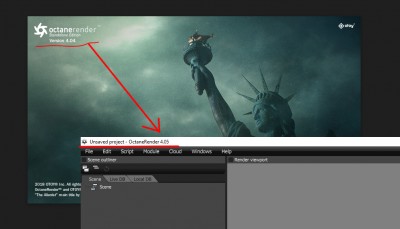

in addition

well it depends on the jobs and the software you use. if you use houdini / octane and stay inside houdini it is usable, clunky with the need to bypass user data access but workable. if you stay in C4D , X-particles and octane is also usable.
but yes i agree with you for octane standalone, impossibility to read per particle attribute in the 4.0 version of a rendering software, 3 years after Octane 3.1 was announced for Q4 2016 with those features, is a little bit frustrating. I have buy 2 2018 license for 400$ thinking that the problem was finally solved with the new vertex texture nodes, and my patience was rewarded , but unfortunaltly this feature only work on poly and not on the 2 types of object that are the most important, curves ( hair ) and particles. it doesn't look to be on the roadmap for 2019. I love octane, it's a beautiful engine, so i guess i'll wait until december before considering a switch , on this other gpu render engine. Many have already done the switch in the FX and motion design sector, but i love unbiased logic , that's the fuel of my patience ... But i start to complain too much on this forum :) , that is a bad sign , maybe i'm starting to be short on fuel.
