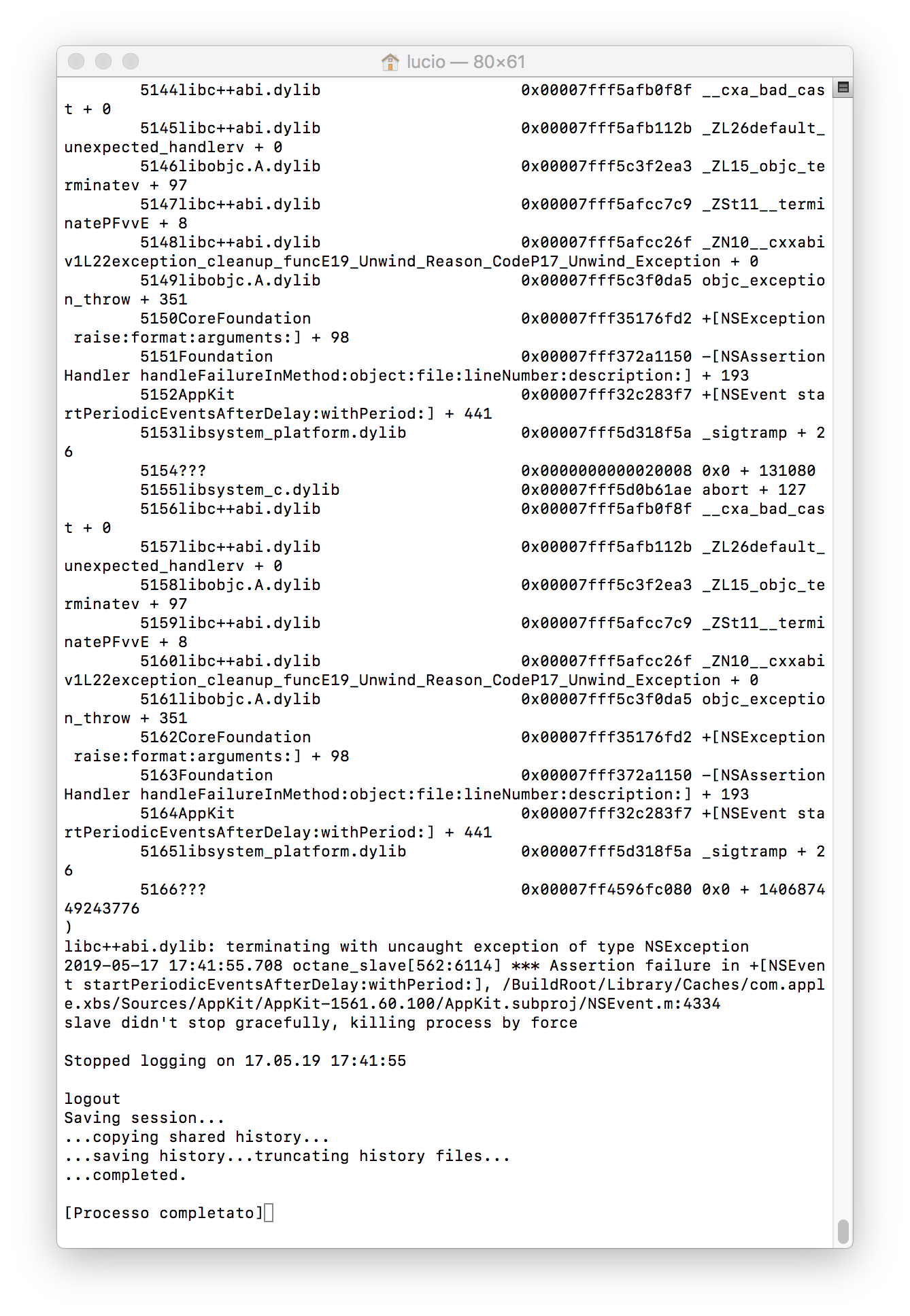

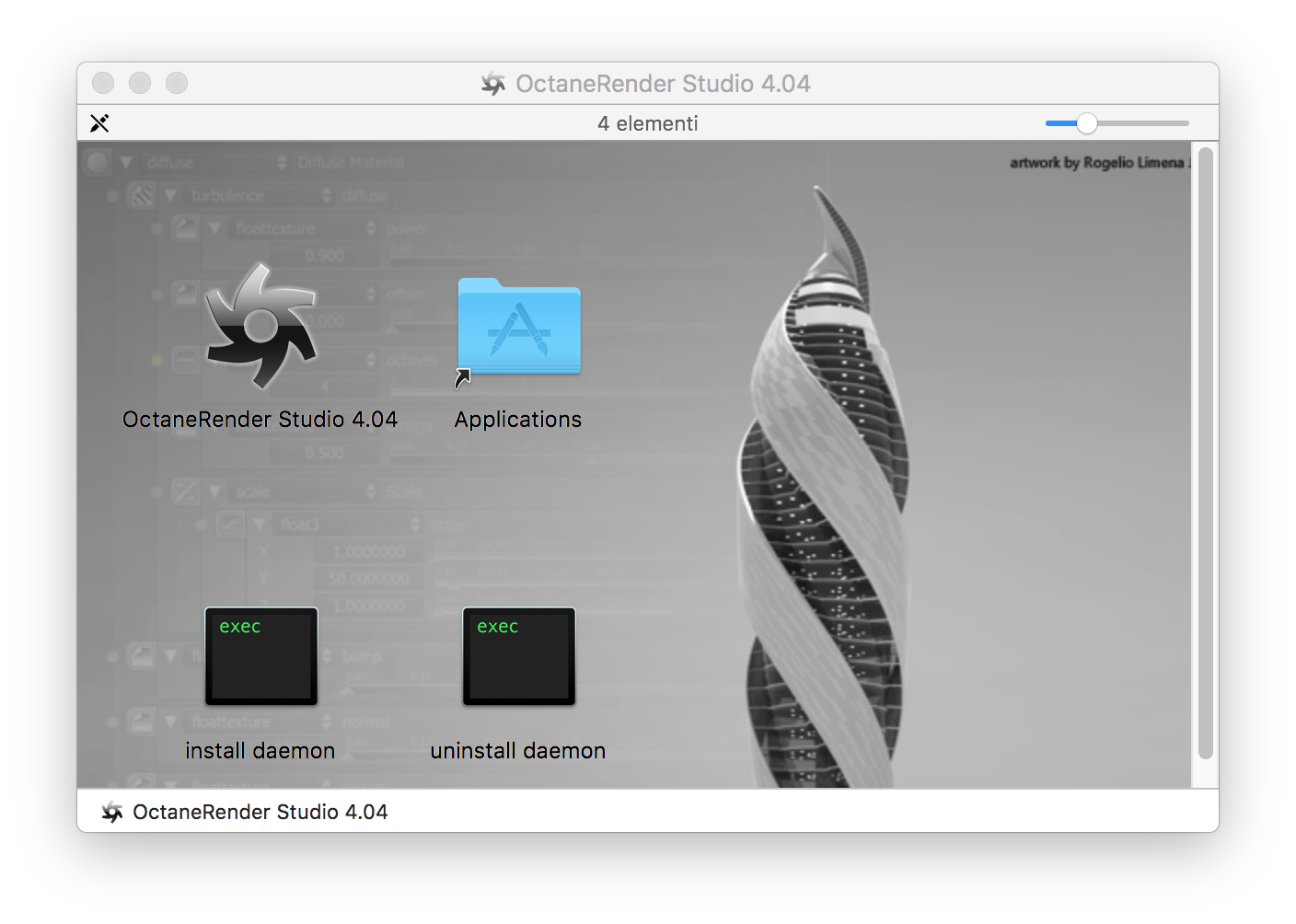

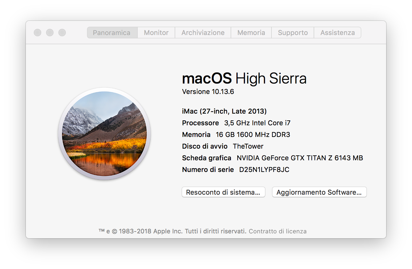

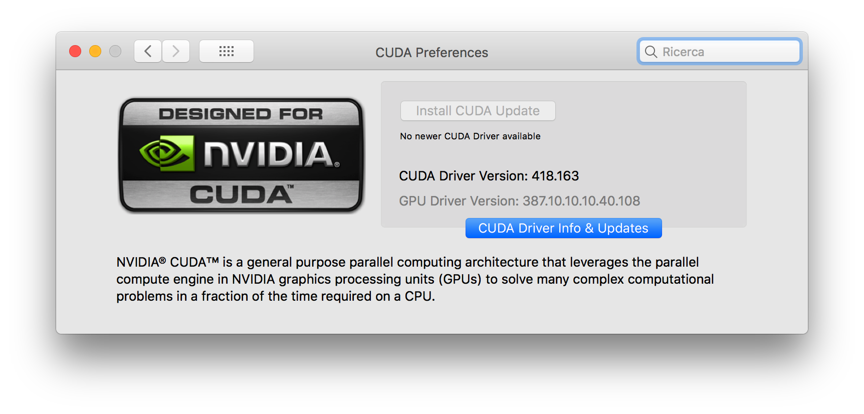

OK. I'm in trouble !
4.04 on main works fine
4.04 sa on slave works fine
daemon on slave doesn't works.
Here's some screenshot.
What's wrong with slave?
L.

beppe, just curious, what is wrong with 418.163? cheers markus
Specs: Apple MacBook Pro M1 max 64GB 2TB, MacOS 12.5 / MacPro 5,1 with NVIDIA GeForce GTX 1080 8G, MacOS 10.13.6 / Mac Pro 5,1 with AMD RX5700 8G, MacOS 12.3.1 / HP Z600 with NVIDIA 3060 RTX 12G, Windows 10 pro + Netstor GPU box, 4 x NVIDIA GTX 980ti 6G.
Posts: 10611
Hi 3dworks,
the question should be asked to Nvidia.
No 418.xx CUDA driver versions are working with OctaneRender, and as far as I remember, it was never happened in the past.
Nvidia has fixed the issue in 419.xx and higher, but never published a fixed version for Mac, at least until yet.
ciao Beppe
