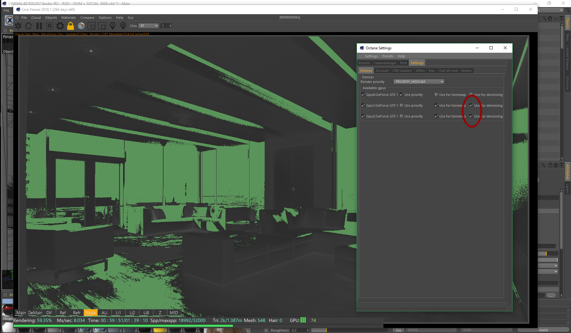

1. Is it possible to make C4D remenber "Use for denoising" user configuration like all others options after reopening C4D?

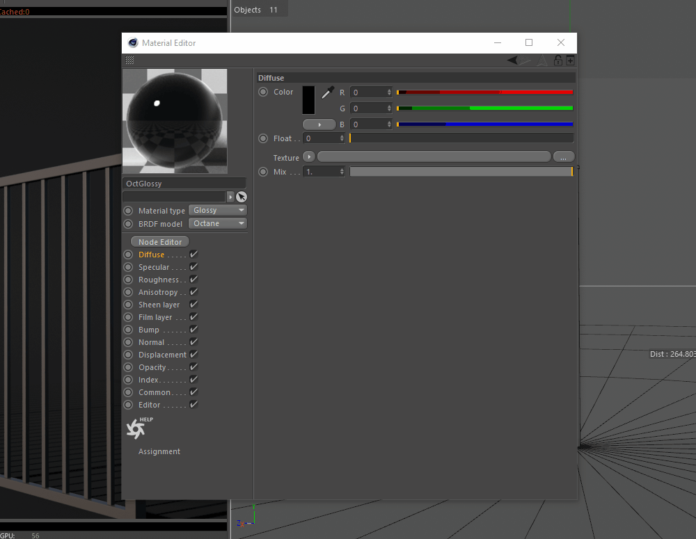

2. I'm having this issue with converted shaders and newly created materials, the Sheen channel behaves weird from the moment it is created. After some tweaking it behaves normally. (see gif)

Kalua wrote:Good Build. Feels very stable. I hope it keeps like this in future upgrades.
Two things:
Cheers,
1. Use a template scene, I think better for people.
2. I'll check it, thanks!
Two things:
Cheers,
1. I mean even for already created and saved scenes. When they are reopened C4D wont remenber what I set. Everything else is remenbered. I wonder why I must recheck it everytime I open a 3 month project.
Thanks,

Kalua wrote: 1. I mean even for already created and saved scenes. When they are reopened C4D wont remenber what I set. Everything else is remenbered. I wonder why I must recheck it everytime I open a 3 month project.
Thanks,
Are you talking about settings/devices section?

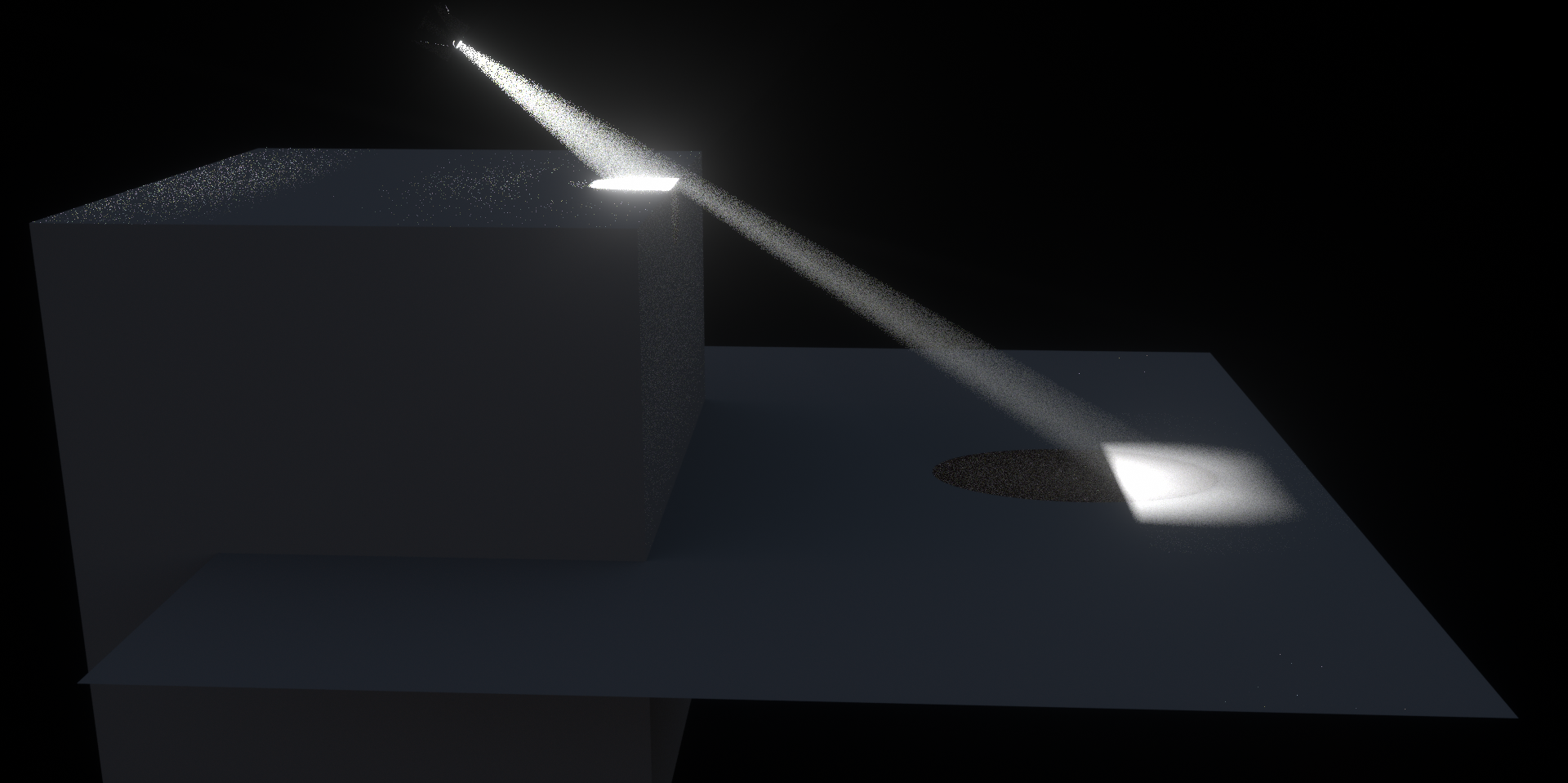

Can I hope for an upgrade of the volumetric spotlight? I could not remove the black shadow and would be comfortable to be able to decide the shape and the diffusion of the light.
Thanks,
Yes.
