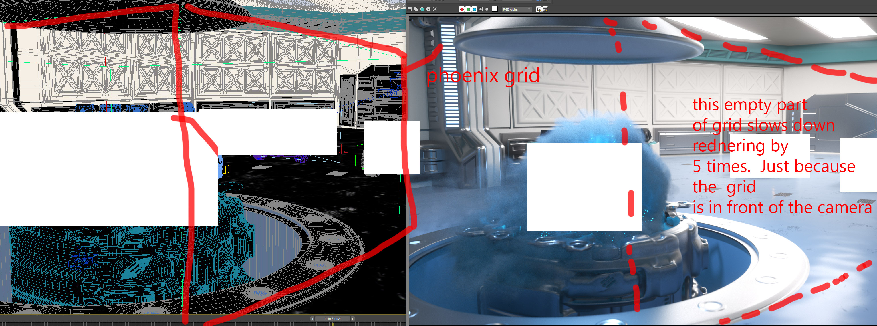

There is still a bug where phoenix's empty parts of grid slow down octane renderer. There is no smoke and octane still slows down by 5 times almost like there is a smoke Please fix it I reported this problem 2 times already.
So there is a problem with transparency where octane calculates clear grid cells as smoke.
Even having just the sim of clear smoke octane will slow down a lot.

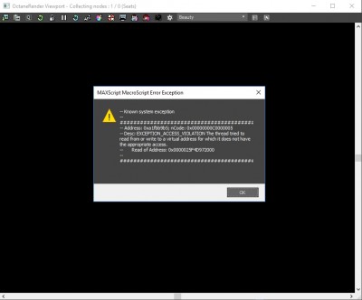

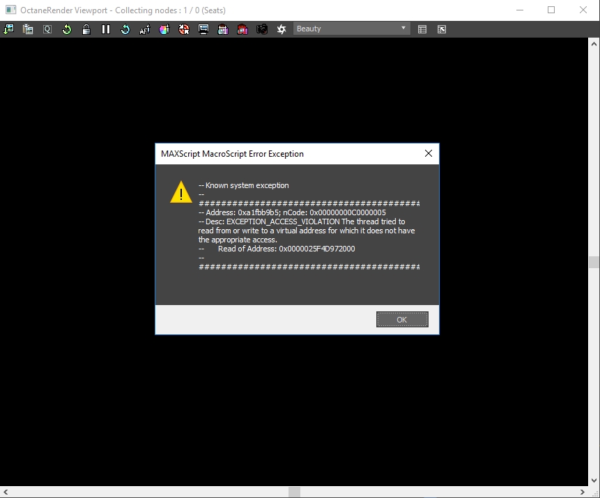

I have a model of a car and it is only 1 million of polygons, but when I'm trying to render it - I got this error message
How can I resolve it?
Cheers
