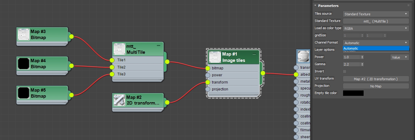

Hi neonZorglub
For image tiles node there is no compression options available. Once again, this feature exists in Standalone
