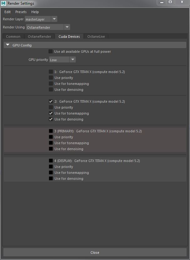

leehenshall wrote:This might be a stupid question...but I'm getting some really bad general Maya interactivity performance when rendering in IPR. It seems like Octane is rendering on my display GPU even though I've disabled my display GPU in the cuda device rollout. When I stop rendering everything returns to normal. Could there be some confusion as to which GPU is my display GPU?
I've noticed my PRIMARY GPU and my DISPLAY GPU seem to be different? could this have anything to do with my poor performance?
I've tried to specify my openGL device for Maya via the Nvidia control panel but still can't seem to get decent interactivity within the Maya interface when rendering.
Can anyone help with this?
Hi leehenshall,
Thank you for the post.
Not sure if anyone is having the same issue but do you also have display monitors connected on the Primary GPU?
Try using MSI Afterburner and post the screenshot.
Also, check if Maya is running on Primary GPU or Display GPU.
Cheers

Thanks for your response. I noticed the performance improves a lot if I use viewport rendering. I think my performance issues could have something to do with using the Maya framebuffer at higher resolutions. If I go above 4K in IPR Maya starts to drop interactivity.
It seems like the Maya frame buffer is having issues handling high resolution images while IPR rendering. It works better at lower resolutions but then my car is like a postage stamp and I cannot see the shaders at highres from the render cam view. The reason the car is so small in frame is because I am matching to a backplate and I cannot zoom my render view to reduce the empty space in the render and reduce the overall resolution because post scale, film offset and 2d pan and zoom are not currently supported in Octane For Maya. (I will post a request for this seperatley)
I am using Afterburner and can confirm I do see activity on the display GPU even though it is turned off for CUDA in the render globals. I think this is more likely to be something to do with handling a large image in the maya framebuffer rather than rending but I can't be sure.
Lastly can you explain the difference between Primary GPU and DISPLAY GPU?
Surely they should be the same GPU which for most people would be GPU 1.

Hi Leehenshall,
Thanks for the video.
It seems Maya is still using the 2nd GPU (Primary) enabled in the CUDA tab.
Primary - is just windows API naming, there is no guarantee is this type used for display by windows or not. It's quite confusing since you have the same GPUs but it is good to know which GPU is used for display.
The plugin just tries to help to the user showing them how windows have typed the GPUs installed, the plugin does not decide anything about the names and meanings of these types, it just directly shows to the user what windows reports about its GPUs.
The Display GPU is also used by the Windows for display and we recommend not using it if you have other available GPUs in your system to not freeze your system with heavy renderings.
Could you try disabling the Primary and see if it make any difference? Hope this help fix the lags.

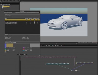

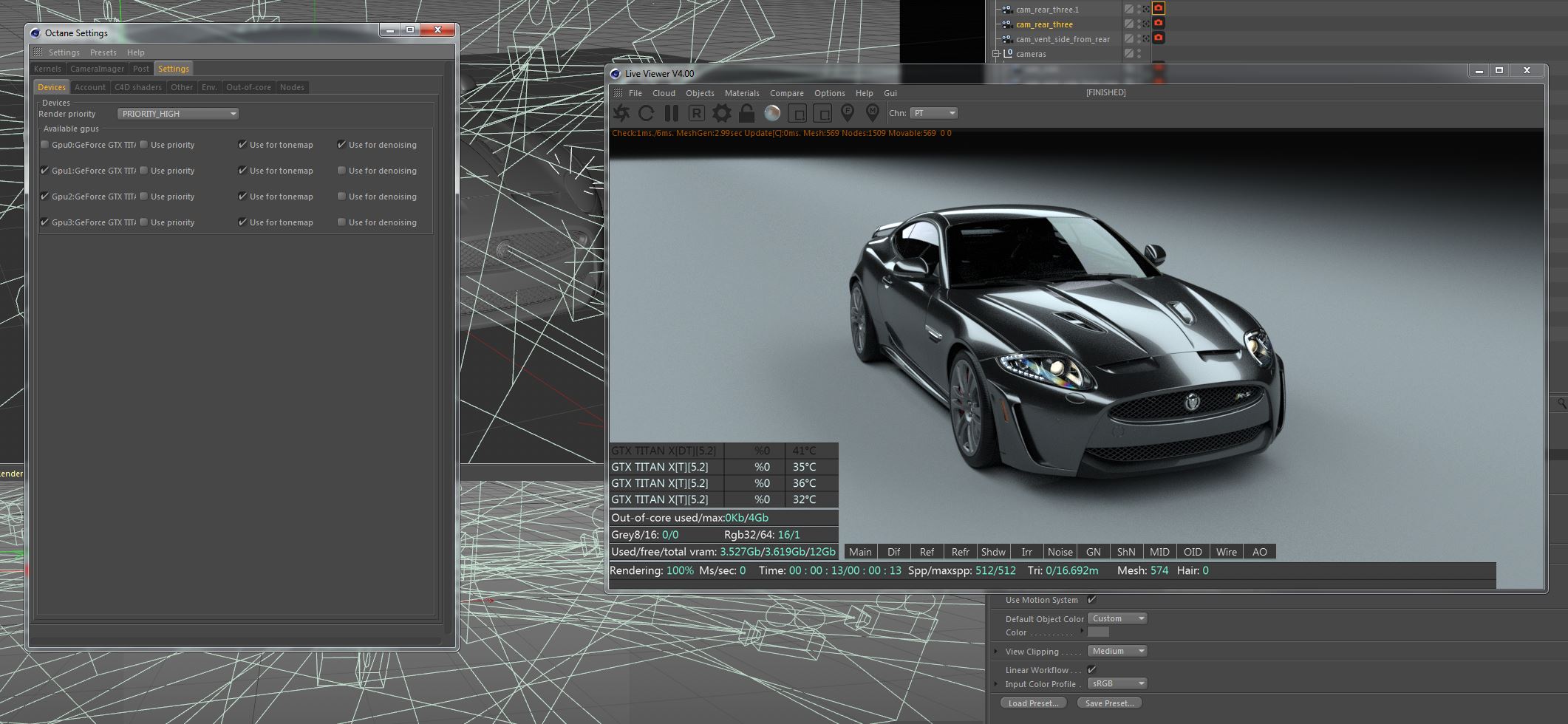

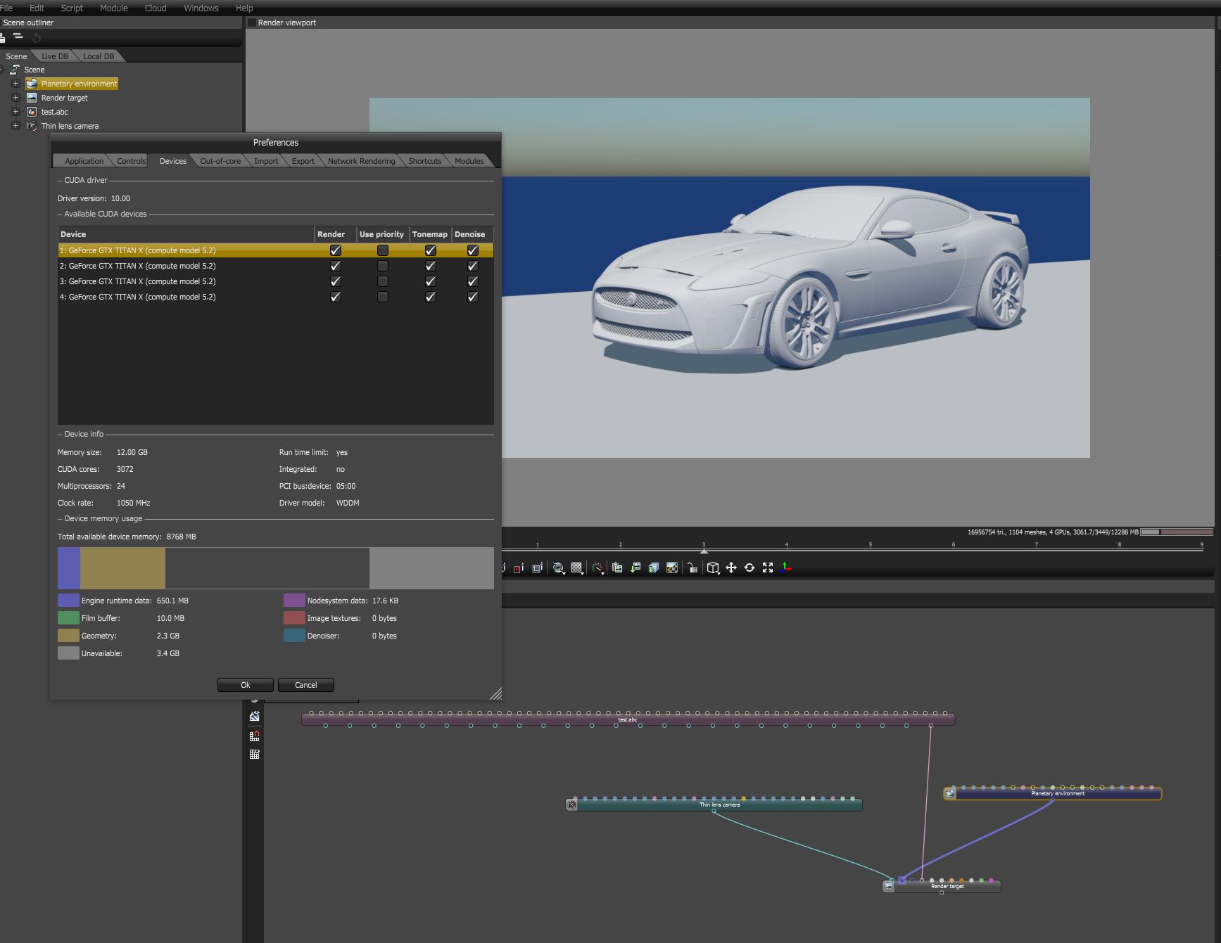

I tried turning off GPUS I also tried changing the wiring of my monitor to different GPUs as well as using display port 1.2 to daisy chain my two monitors off of a single display port.
When ever I change my monitor wiring the PRIMARY & DISPLAY GPUS seem to change to unexpected GPUS:
Mean while all is well in the land of Octane 4 C4D:
Everything is rapid in Standalone:
This seems like a Maya plugin problem. It could be user error on my part but what ever the problem is it's not obvious.

leehenshall wrote:I tried turning off GPUS I also tried changing the wiring of my monitor to different GPUs as well as using display port 1.2 to daisy chain my two monitors off of a single display port.
